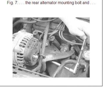

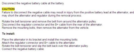

Can you please send me step by step instructions on how to replace an alternator. Thank you

This info for 2.2L
