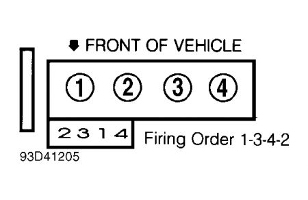

1996 Chevy Cavalier 4 cyl Front Wheel Drive 150000 miles
can not find a dist, cap to plug wires in how do I get to where they go?
Thursday, April 2nd, 2009 AT 9:59 AM
2CARPRO JACK
  • 11,533 POSTS
It doesnt have a cap and rotor, most likely DIS (distributorless igntion system) The coil is mounted on the block under tehintake manifold, there isnt really an easy way to get to them
https://www.2carpros.com/forum/automotive_pictures/1639_cav_1.jpg
