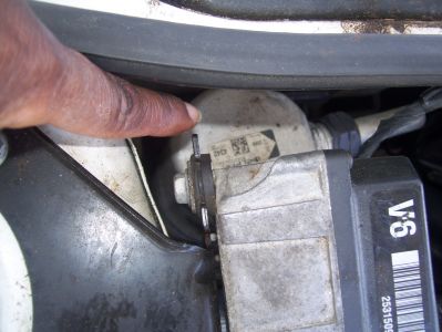

I have a picture of the place where the noise is coming from. It is a 2001 Chevy Cavalier an the noise is when I drive that I here the screech noise and a clicking noise. Someone told me it was the assembly pulley.

Pic is too close up to tell much but that is not a pulley what your pointing at
