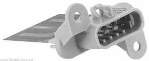

Hi there well the heater from the start gas not worked properly for me just worked on high, now it just totally concked out I cannot afford to fix it at this moment but was wondering if there was a way I could hardwire it to the battery for it to run, have early mornings for work and it is usually chilly windows all frosted up hard to drive. Lol

Your blower motor resistor has burned out. It retails for $22 from rockauto.com
https://www.2carpros.com/forum/automotive_pictures/55316_96cavalierresistor_1.jpg
