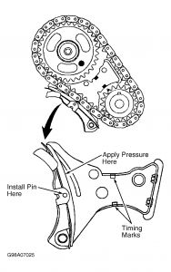

We cant get the timing set right can you tell use how to set the timing on a 2.2L motor?
Thursday, September 16th, 2010 AT 8:09 PM
  • 110,194 POSTS
Here is what I found. Let me know if it helps or if you have something different. It's for a 2.2L cavalier.
http://www.2carpros.com/forum/automotive_pictures/249084_5_69.jpg
Friday, September 17th, 2010 AT 7:32 AM
SCP1962
  • 8 POSTS
Okay we have the timing set like the diagram and now it backfires and wont start
Friday, September 17th, 2010 AT 12:21 PM
  • 110,194 POSTS
Are you sure the plug wires are on the correct cylenders? Are you sure you are not off one tooth on the timing?
Friday, September 17th, 2010 AT 1:45 PM
SCP1962
  • 8 POSTS
The timing looks set right on the marks and the spark plug cables are on the correct cylinders we dont know what is wrong now.
