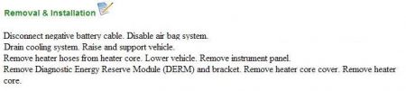

heater only gets luke warm sometimes cool, fluids are right, hoses to heater core are warm is this probaly clogged core

What is temperature gauge showing? If its normal then may be partially clogged heater core or radiator. If its showing a little cooler than normal then may have a sticky thermostat.

Do I have to take out dash to change, its got new radiator and themostat

To replace what?

Heater core

https://www.2carpros.com/forum/automotive_pictures/261618_Noname_1674.jpg

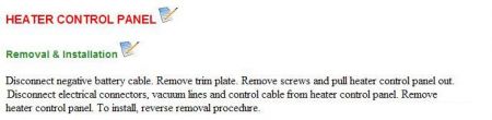

https://www.2carpros.com/forum/automotive_pictures/261618_Noname2_523.jpg

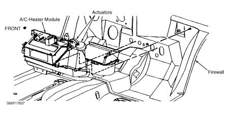

https://www.2carpros.com/forum/automotive_pictures/261618_Noname3_201.jpg
