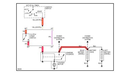

new battery, alternator, starter and still cant get the car to say a word. Will not even turn over, turn the key and it makes a small clicking noise but thats it.

Have helper hold the key in start and also depress the clutch and look for power at the purple wire on the starter solenoid-do you have it? If not test the clutch switch or jumper it and see what happens-still won't crank test the ignition switch
https://www.2carpros.com/forum/automotive_pictures/12900_starter_19.jpg
