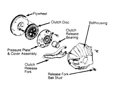

Hi
Has this developed over time? How many miles on clutch assembly? Maybe worn ball seat and fulcrum on fork binding.
https://www.2carpros.com/forum/automotive_pictures/198357_Graphic_392.jpg
Let me know

Fork moved easily? Bearing contact surface clean and lubed? Why no replacement of pressure plate and disc?

Didn't say anything about clutch I said fork the thing that operates throwout bearing
