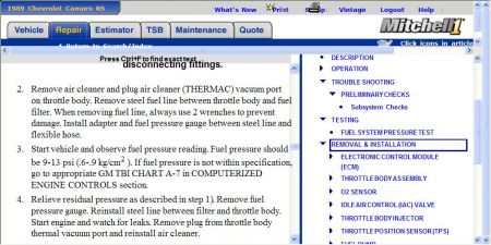

My car wont pass gas to fuel filter, replaced fuel pump, fuel filter, fuel pump relay, but wouldnt start, then we took fuel filter off to see if gas was pumping to fuel filter and it wasnt, the fuel pump turns on for bout 3 to 5 seconds so we think its working just gas does not have any pressure ccoming up to even get to fuel filter just need to know what I ciould be.
