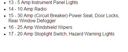

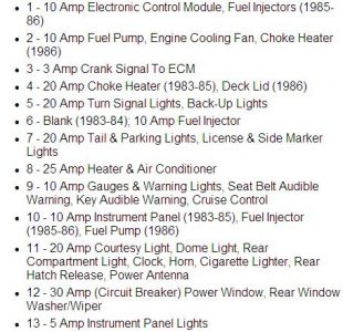

i need to know the fuse placement for the fuse box under the dash

I can't guarantee the above info, it is what the database showed. goodluck.
