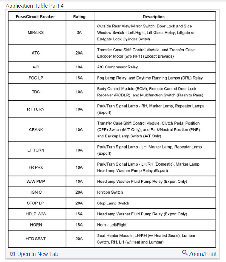

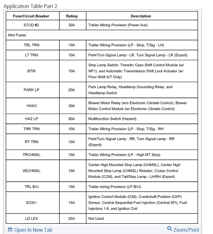

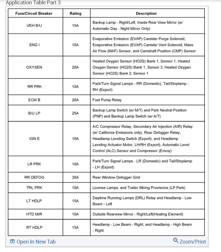

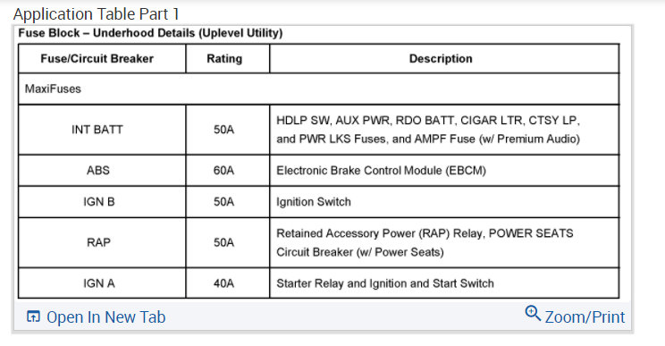

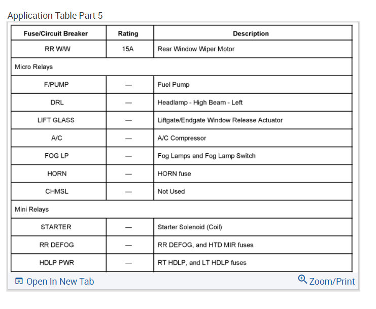

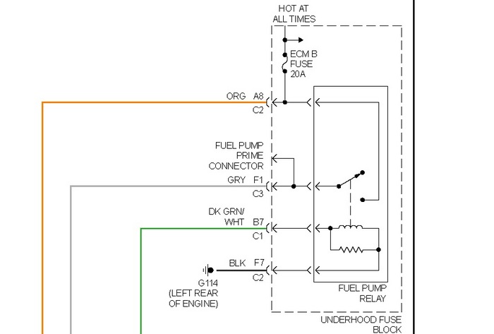

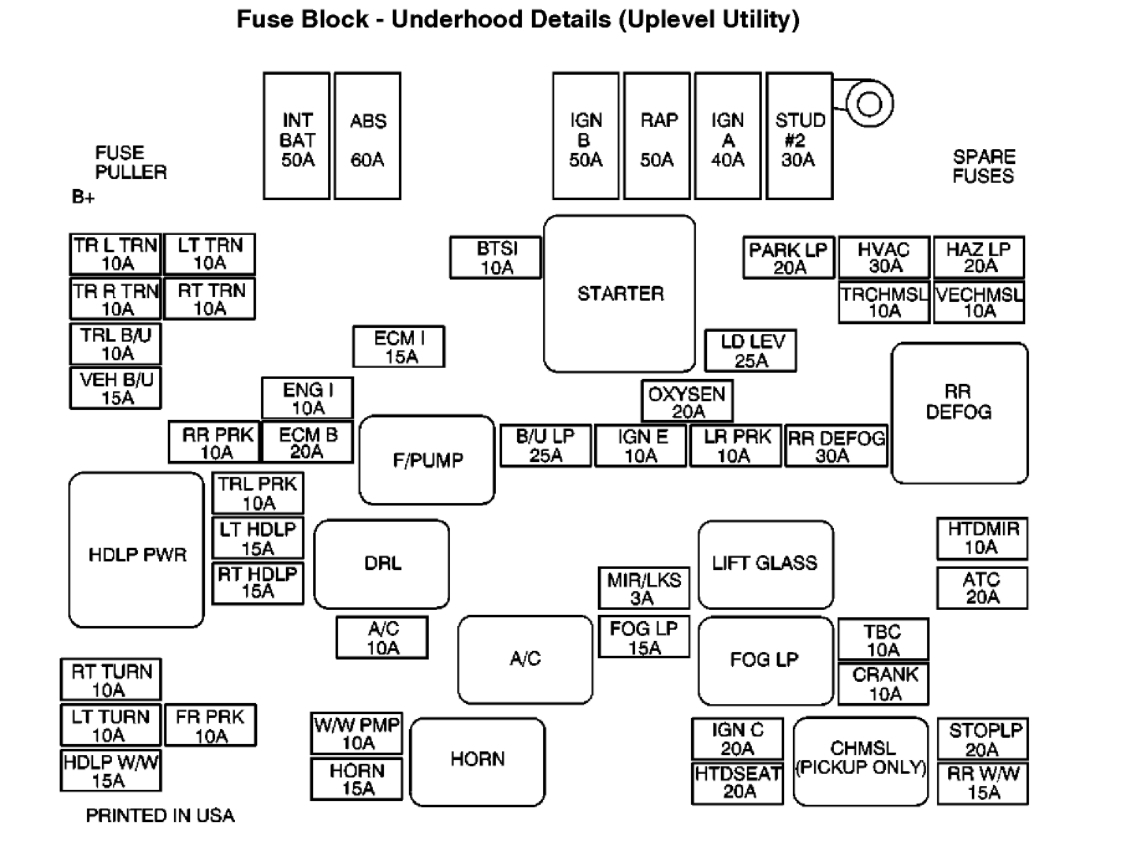

fuel pump relay is in the underhood fuse block (on top of left front inner wheel well). if the fuel pump is not coming on, test the fuse, fuel pump relay and wiring to the pump. if all is OK, supply direct 12v power to the pump, if it comes on then must have wiring issue somewhere. if it doesn't come on then pump needs replaced. HEre is guide to help test the relay and the location int hediagrams below.
Check out the diagrams (Below). Please let us know what you find.

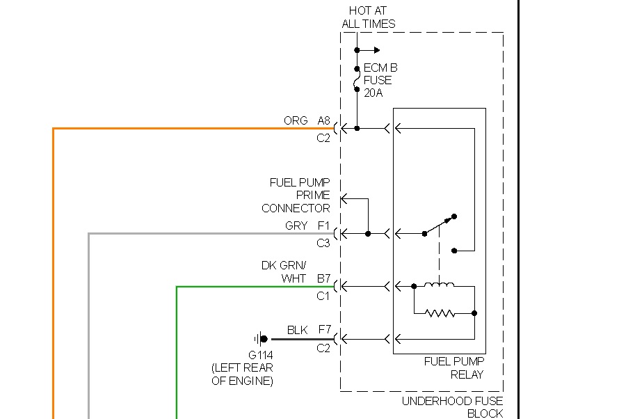

Good evening,
I attached a wiring diagram for you to view.
The relay is in the under hood fuse block and you need to remove it and test for voltages.
You need a constant 12 volts that is fuse controlled as in the diagram. Then the green/white wire is from the ECM for 2 seconds with the key on. It will have full power cranking.
The gray wire is the wire to the pump.

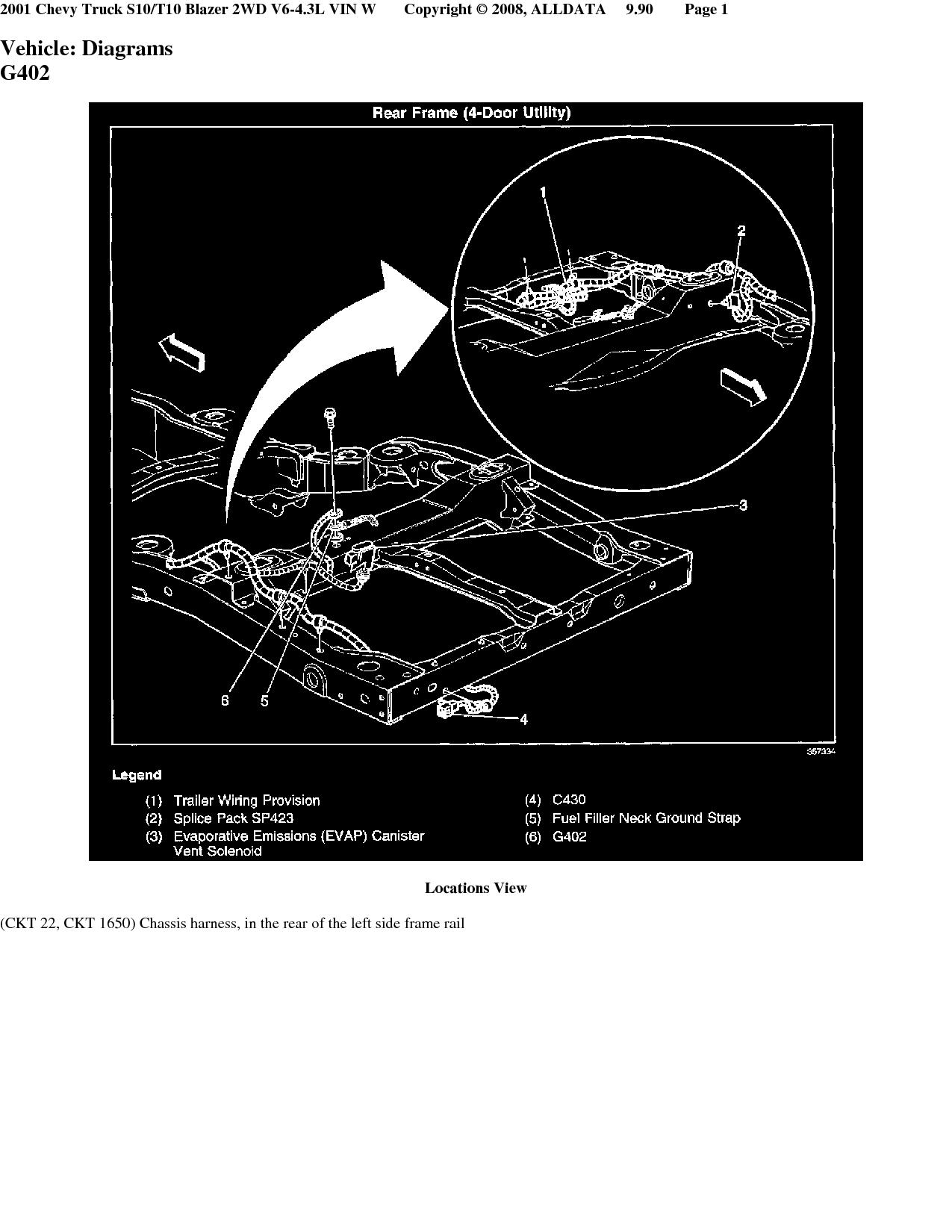

NICKB275
  • 24 POSTS

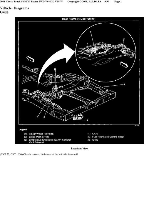

Ground wires were notorious for these models at the frame rail near rear bumper. Make sure the ground is against good clean metal. Get under the car and follow the harness coming from fuel pump and follow the ground wire indicated by JDL, this will hit frame at some point, you really want the best ground from tank to chassis, I have seen many GM pumps changed for ground reasons, also many pump fried due to bad ground and burnt pump.
Jan 30, 2021 at 8:16 AM (Merged)
NICKB275
  • 24 POSTS
figure 6 is fuel pump ground conection # C402. Look at the #6 in figure on the frame. This is a ground which usually causes problems. Not saying this is 100% your problem, but should not be overlooked.

First check the ground wire for the fuel pump. The ground should be the black wire. It goes from the fuel pump (connector) and terminates either just before the gas tank,to the frame crossmember -or-to the frame somewhere after the gas tank. The ground on these systems (for some dumb reason) is connected to the frame, close to the gas tank, and it is exposed to serious corrosion. It should be accessable without removeing or dropping the tank.
Follow the wire harness along the inside of the frame rail just before the gas tank. The ground will jump out of the wire loom somewhere and terminate to the frame.

I found the ground and it is connected. The pins are a flat rectangle. I am going to take the tape off just to make sure it didn't come apart in there. I have checked every fuse that I have also. May have been a waste of time but why not. It is looking more and more like the pump.
Jan 30, 2021 at 8:19 AM (Merged)
PEAR69
  • CERTIFIED EXPERT
  • 1,482 POSTS
Clean the ground up real good, take it off and sand the connection with some sand paper or something. Jump out terminals 85 and 86 again just to see what happens. The ground can corrode behind the termination point--not visible.

I AM IMPRESSED!!! I took the ground off. It was ok but...there was road grime and crud under it on the frame and some rust. I cleaned it off and sanded down the frame where it connects. Reconnected it and as I walked by the door I just had to see. I put my key in and tuned it to on. The pump kicked on. Oh and then it started the first time. I mean I didn't have to cycle the key to prime it. After seeing that mess I climbed under and cleaned every ground I could find. That should save me trouble in other areas as well. And yes most of the grounds were all the same with grime, rust and crud. After doing all of them I started it again. FIRST TIME START AGAIN! It runs great now. I can actually feel a differance in power. The pump must not have been working right from the start because of a bad ground. I was afraid to jump out terminals 85 and 86 after it started right up. Because I don't know if it would cause harm now that it is working right. LOL
