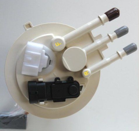

Hello again!! we got the fuel pump put in. it took forever to get it started ..but it finally did. Then we were given it water and it just keep drinkin it ...looked at the oil...and it was milky...so we just thought it was a blowen head gasket.. so we started taken it apart got to the intake gasket. and it was blowen ...so we got a little lucky. and thats where we are know.....but i had another question for ya...my gas gauge is stuck on fuel....its just layin there...when its running, when the keys out, on everything its just laying there...

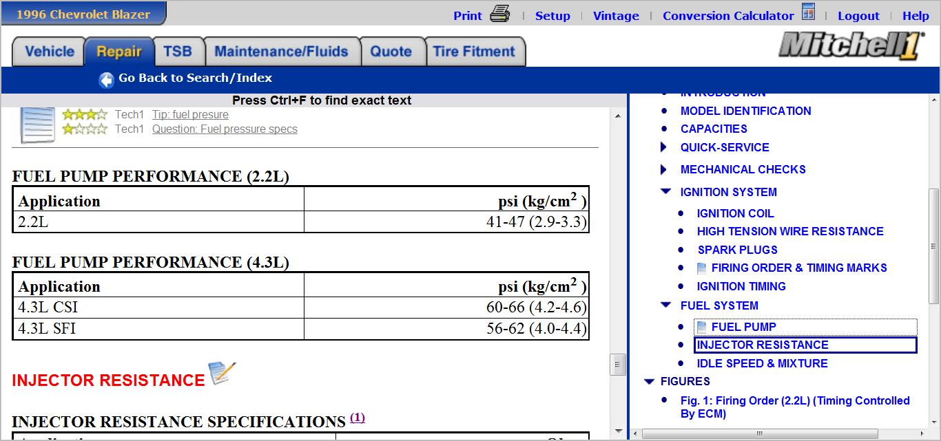

You need a fuel pressure gage. If the pressure is low, the problem is usually on the supply side, pump, line, fuel filter, the pressure regulator may go either way.
According to the parts book, you do have the spider system.
Aug 22, 2019 at 6:32 PM
(Merged)
Also what it starts at and what it drops to in 5 mins.

Fuel pressure should be 55 PSI and above V6 3.8 W
if not fuel pump is at fault

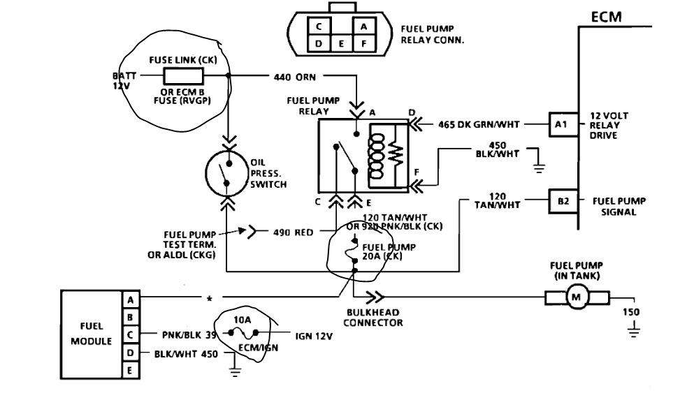

I'm just trying to find out what voltage should be going to the fuel pump. It has an ECM command to a fuel pump module but all the schematics show 12v going to the module but not what is coming out to the pump. If I give it 12v, the pump runs full blast, it puts out about 50 psi. Any help would be greatly appreciated.
(Merged)
Good morning
The pump needs a battery voltage to run.
I attached a diagram for you. 12 volts is supplied to the control side of the relay to energize the load side. Check for that voltage with key on and cranking.
The load side has battery voltage all the time and is fed from a fusible link. It may be located at the starter solenoid.
Then when the relay energizes, it sends power to the module and then off to the pump.
Verify all powers to the components. I circled the fuses you need to test for power. This is not a visual test, you need to check for power with a test light or voltmeter.
