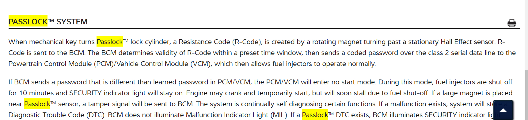

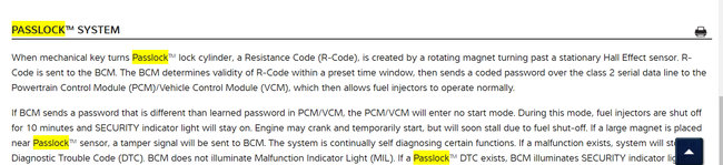

We disabled the security system as our spare key stopped working. It will turn the radio on and crank but not start while flashing security. So we took out the security module by the ignition and it fired up, but the next day nothing. So we cut the orange and yellow wire and tied them together along with resetting the system by turning the key and waiting ten minutes. We did that three times the security stayed solid but still never started.
Monday, February 1st, 2021 AT 9:03 AM (Merged)
SCGRANTURISMO
  • 4,897 POSTS
This will not work. The only way to get your vehicle to start and run is to reinstall it's PassLock security system and get either the dealership or a locksmith to make you the proper ignition key. This is intentionally done to keep thieves from being able to bypass your vehicle's security system and steal it. In the diagrams down below I have included a description of how your vehicle's PassLock security system works. Please go through it and keep us advised as to how things work out.
