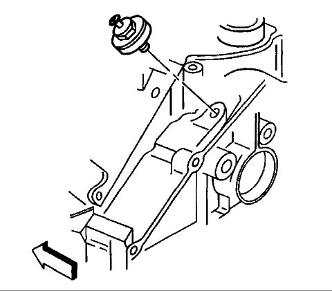

I can't find the knock sensors
NUMPY05
  • 2001 CHEVROLET BLAZER
  • 6 CYL
  • 4WD
  • 170,000 MILES
I can't find the knock sensors I know they should be under the head but I don't see them
Wednesday, January 20th, 2010 AT 5:48 PM
19 Replies

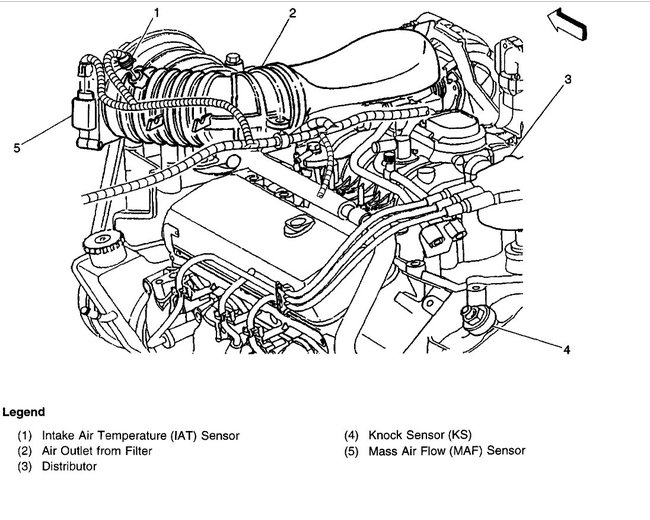

BLUELIGHTNIN6
  • 16,542 POSTS
The knock sensor (KS, only one of them) for the 4.3L engine is located on the top rear of engine, pic below..

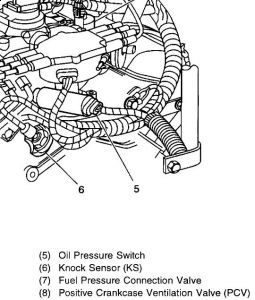

My knock sensor is throwing a check engine light and I have no idea where it is located. Can you help

Friday, January 29th, 2021 AT 10:31 AM (Merged)
KEN L
  • MASTER CERTIFIED MECHANIC
  • 55,469 POSTS
The knock sensor is located at the rear of the block near the firewall at the transmission flange. Here is a diagram (below) to help you see where it is. Please let us know if you need anything else to get the problem fixed.

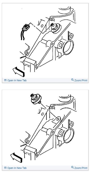

GFUNARO
  • 1998 CHEVROLET BLAZER
I am trying to locate the knock sensors for a 98 chevy blazer with a v6 engine. I cannot find them anywhere! I looked all over the block and around the starter. The book says " located in engine block. One under left bank cylinder head, and one under right bank cylinder head." Please help.
MIKEYBDMAN
  • 623 POSTS
No wonder. Approach the engine from the left side, and look under the distributer. It appears to be located just forward of the transmission bellhousing, and just on the left side of top of the engine block. It is aft of the left head, and almost looks like it is right on the flange of the engine to tranny mount.

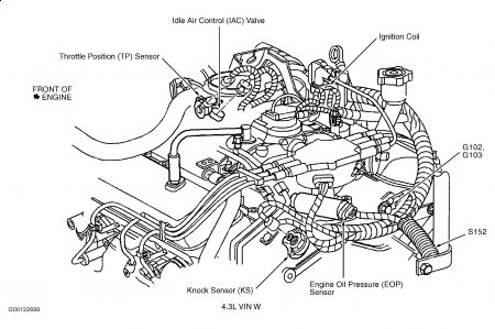

Where is the knock sensor located?

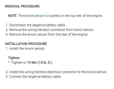

DOCHAGERTY
  • 9,603 POSTS
At the top rear of the engine, behind/below distributor.
See the guide below for an idea of what you are in for
https://www.2carpros.com/articles/how-a-knock-sensor-works
Vehicle specific instructions/diagrams are attached below

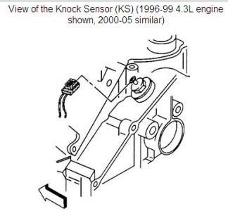

Where Will I Find The Knock Sensor?
JDL
  • 16,098 POSTS
https://www.2carpros.com/forum/automotive_pictures/170934_knock_sensor_1.jpg
Looks like rear of engine, two wire connector.

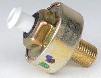

I went to auto zone to put have my blazer checked for my :engine soon light was on: the gentlemen read three codes 1 egr was bad then my knock sensor was bad but as im driving ive never heard knocking is there something else im missing? I need help ty
+1
Friday, January 29th, 2021 AT 10:32 AM (Merged)
BLACKOP555
  • 10,386 POSTS
Can you get the exact codes for me? They may not be bad.
A knock sensor is a piezo type sensor that senses engine detonation and then changes ignition timing to prevent damage to the cylinders.
You wont hear a knocking sound necessarly, probably only when going up a steep hill.

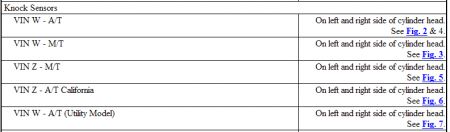

1994 Chevy Blazer 6 cyl Four Wheel Drive Automatic 135xxx miles
where are the knock sensors located at on my blazer? I was told just above the oil pan on either side, is this correct?

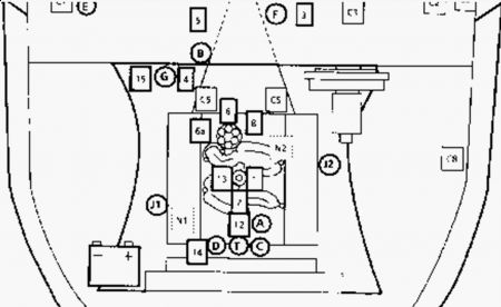

MERLIN2021
  • 17,250 POSTS
I will assume if it's a six, it's an s10 blazer? There are several location depending on your VIN here's the list.
K1500 full size is different!
https://www.2carpros.com/forum/automotive_pictures/62217_BlazKnock_1.jpg
https://www.2carpros.com/forum/automotive_pictures/62217_Bla_1.jpg
At J1 and J2
JSPEED76
It is a 1994 s10 blazer tahoe lt 4.3 vortech. The diagram you put up looks right, I def have one where J2 is but I can't seem to find the other one. And is there anything I should know about the replacement?
-1
MERLIN2021
  • 17,250 POSTS
Do you have a scan tool that reads sensor data? If yes, start the truck, attache scanner, tap on head near the knock sensor, look for change in the way the graph or line representing the sensor looks, also check for timing to retard a bit when you tap, if these happen, the sensor is OK! As far as location I only posted what I found, havent replaced too many of them!
