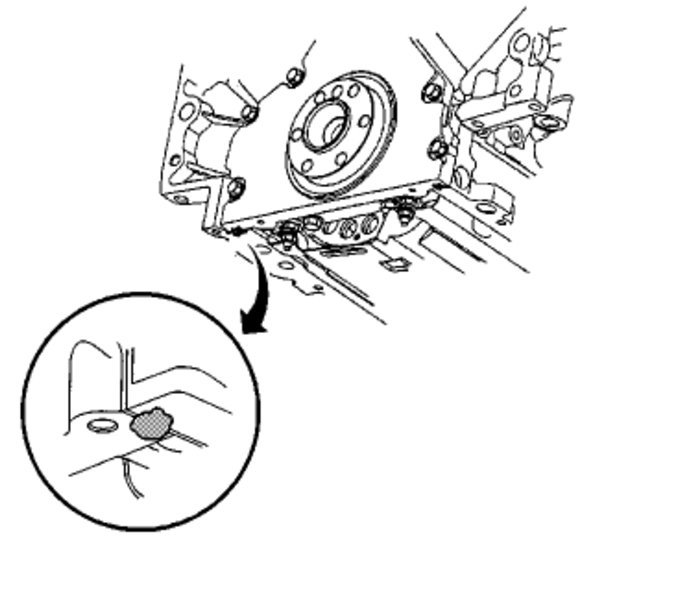

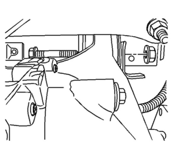

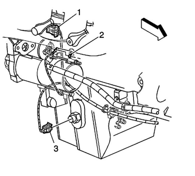

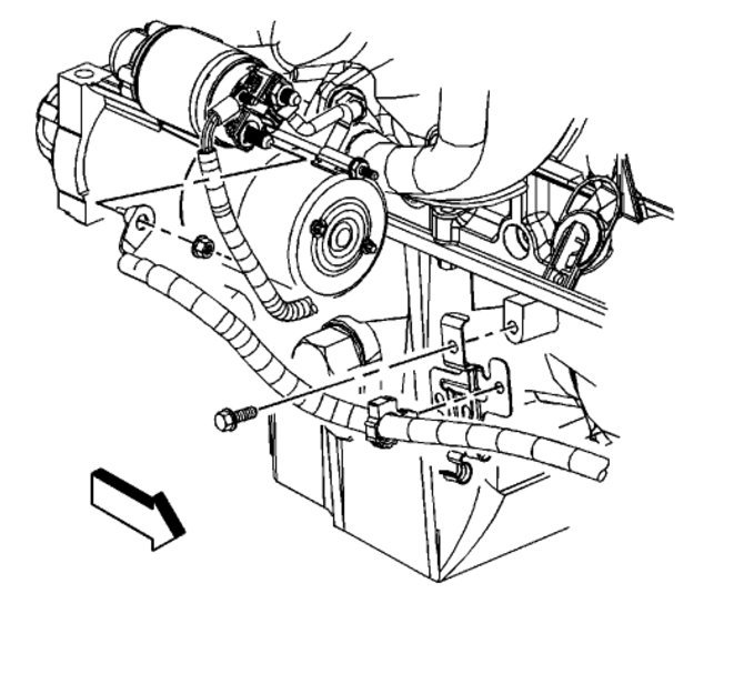

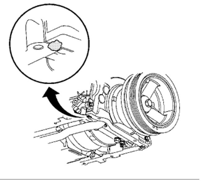

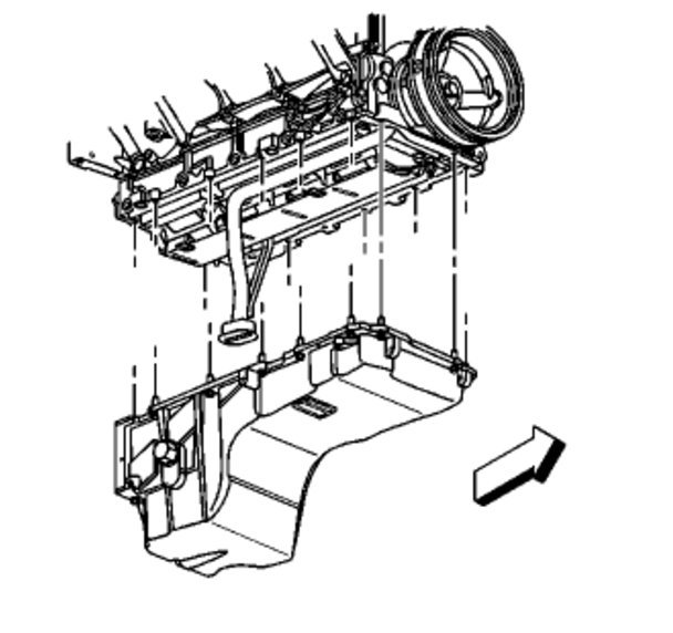

These engines are roller cam and lifters so it normal for them to make a little noise at idle. Also, it could be a wrist pin that is seized up.
Since there is no sludge in the engine I don't think the oil pump pick up is clogged but you never know.

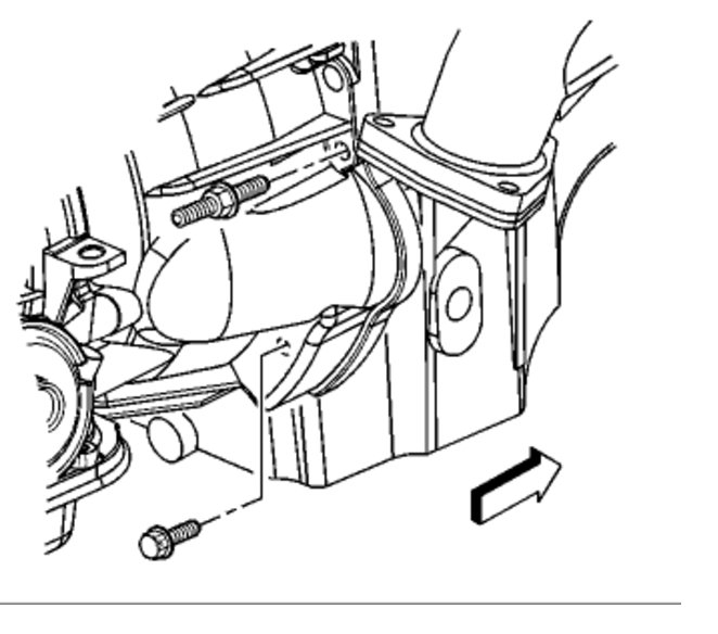

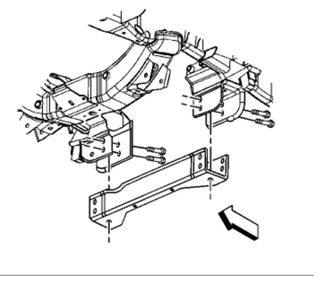

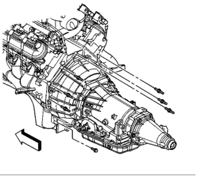

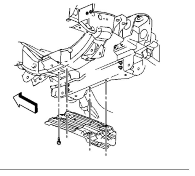

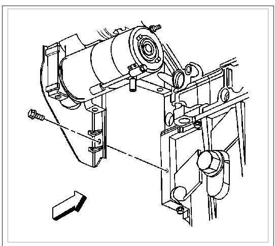

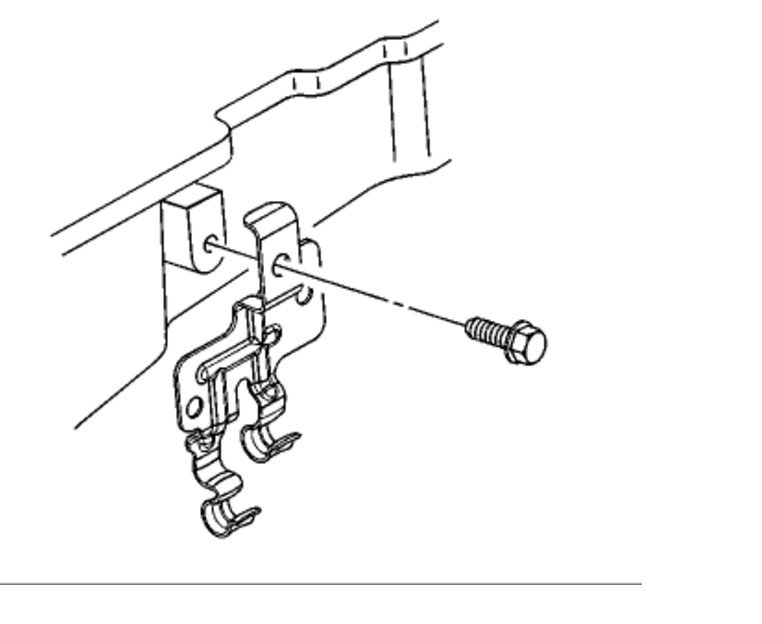

Lastly the oil pump pressure relieve valve could be stuck which means the engine needs a new oil pump. You will need to remove the oil pan and pump to see whats going on.
Here are diagrams to help (below)
Please let us know what happens, we are interested to see what it is.
