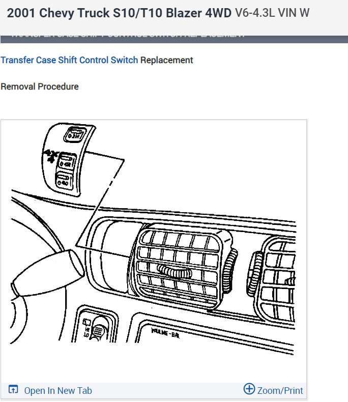

When I push the 4 HI button to engage 4 wheel drive the light just blinks. It doesn't make any sound it only blinks. What could be wrong?

There is a fault code stored in the transfer case control module. The 4wd will not work until the fault is repaired.

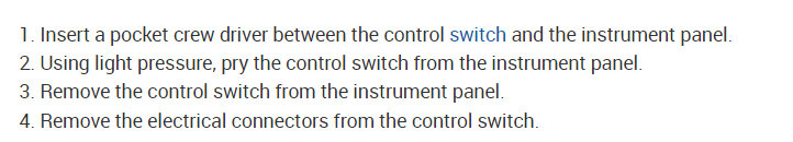

I had this happen to my truck and it was the 4x4 control switch, here is how to change it out to help fix the problem. Check out the images (below). Let us know if you need anything else.
