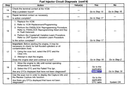

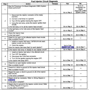

Below is the Diagnostic Proceedure, right click and Save Picture As in order to zoom in to read...
https://www.2carpros.com/forum/automotive_pictures/188069_injectortest__1.jpg
https://www.2carpros.com/forum/automotive_pictures/188069_injectortest_1.jpg
Post results here......
