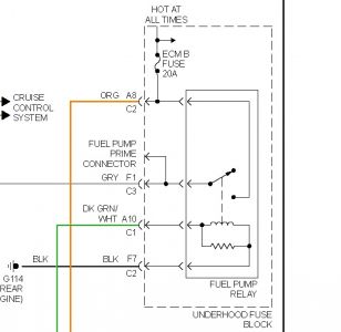

I replaced a fuel pump in my 99 blazer and now I have no power to fuel pump

Engine cranking, do you have an injector pulse, use a noid lite. Did you check for voltage at the fuel pump relay? I always look for an rpm signal? You can check ecm B fuse for voltage.
https://www.2carpros.com/forum/automotive_pictures/170934_blazer_fuel_pump_3.jpg
