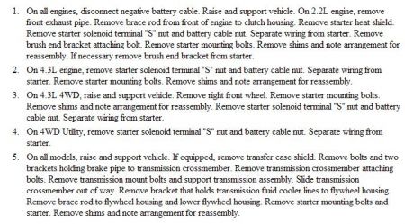

1998 Chevy Blazer starter replacement
MARICA
MEMBER
1998 CHEVROLET BLAZER
1998 Chevy Blazer
how to replace starter
Tuesday, June 9th, 2009 AT 8:16 PM
BLUELIGHTNIN6
MECHANIC
16,542 POSTS
-1
Tuesday, June 9th, 2009 AT 8:21 PM
