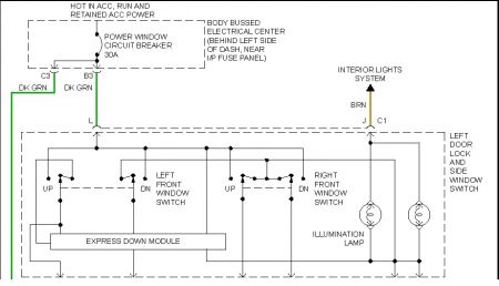

1998 Chevy Blazer 6 cyl Four Wheel Drive Automatic
none of the power windows will work. Have changed all fuses. The power locks are the only switch that will work on all doors. The power windows will not roll down using any of the switches on any of the doors (all four). Changed out the master switch driver side and it did not fix it. Can you tell me whats got all windows not working please?

Did you use a voltage tester at the power window circuit breaker. Should go hot when you turn on the key. Also, where the wiring harness goes into the driver door, If the wires are protected by a rubber boot, sometimes you can pull the boot back far enough to check wires. Dark green wire is voltage to the master switch. Black wire is ground. With so much movement with the driver door, sometimes those wires break.
https://www.2carpros.com/forum/automotive_pictures/170934_blazer_power_windows_1.jpg
