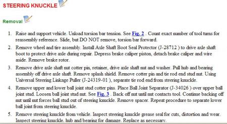

How do I remove the lower balljoint on a 1996 chevy blazer?

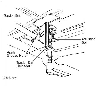

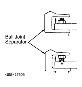

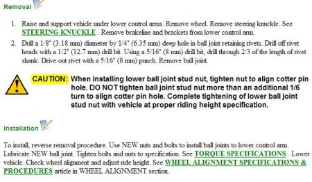

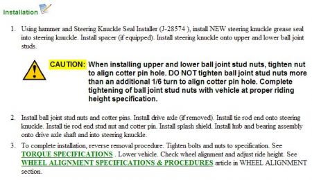

Ball joint removal see text.
Mark (mhpautos)
