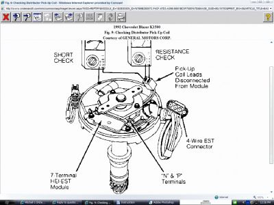

1992 Chevy Blazer 200000 miles
I have a 1992 Blazer, and all of the sudden it won't start. It carnks fine, and there is fuel getting to the engine, but it simply won't fire. I got a code from the engine light, something like -. What does that mean? Anky help would be great!

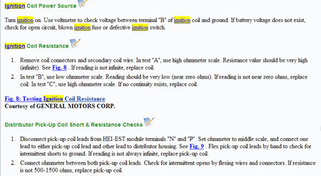

Check for power at the coil, spark at the coil, if it has power but no spark, check the HEI/EST module in the distributr, and the pick up...This is general in nature since you listed no engine size...
https://www.2carpros.com/forum/automotive_pictures/62217_CoilTest1_1.jpg
https://www.2carpros.com/forum/automotive_pictures/62217_CoilTest_1.jpg
https://www.2carpros.com/forum/automotive_pictures/62217_HEIEST_1.jpg
https://www.2carpros.com/forum/automotive_pictures/62217_Ignition_CircuitV8_1.jpg
