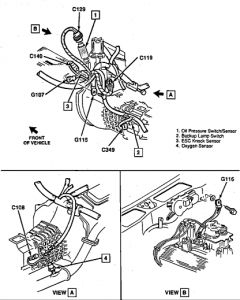

I am attempting to replace the 02 sensor but it is very difficult to remove. Just want to verify which direction it screws out. Is it clockwise or counter-clockwise for removal?

Hi garywillis,Welcome to 2carpros and TY for the donation.
To remove oxygen sensor turn it counter clockwise.
The oxygen sensor has a permanently attached pig-tail and connector. This pig-tail should not be removed, since removal will affect proper operation of the oxygen sensor.
Disconnect electrical connector from oxygen sensor.
Using suitable wrench, carefully remove sensor from exhaust manifold or pipe. The oxygen sensor may be difficult to remove when engine temperature is below 120 °F. Use caution, since excessive force may damage threads in exhaust manifold or pipe.
If new sensor is being used, install sensor into manifold or pipe.
If old sensor is being reused, coat threads with anti-seize compound, Part No. 5613695 or equivalent, then install into manifold or pipe.
Torque oxygen sensor to 30 ft. lbs., then reconnect electrical connector.
Exhaust System Components-2.8L
https://www.2carpros.com/forum/automotive_pictures/12900_o_5.jpg
Rear Of Engine.

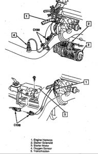

https://www.2carpros.com/forum/automotive_pictures/12900_o1_4.jpg
LH Rear Of Engine, At Exhaust Manifold Collector
