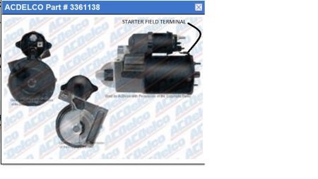

My car wont start if it has been off for more than 7 or 8 hours then will start if jumped. When I turn the key it will just go "click" and nothing will happen, sometimes if I hold it in that "click" position for two seconds it starts. Most times I have to jump it. As long as I drive it or start it every couple of hours Im fine. What is the problem please?

Make sure the battery has a full charge and battery connections are clean and tight on both ends. Check engine grounds, where applicable.
When problem occurs, the purple wire at the starter solenoid S terminal should be hot with the key in the crank position. Also, check the starter field terminal, that should be hot, key in crank position. Right now, I can't tell if problem with wiring circuit to the starter or starter problem. It sounds like your battery has a low charge. Any circuits, check the actual voltage reading.
https://www.2carpros.com/forum/automotive_pictures/512072_beretta_starter_1.jpg
