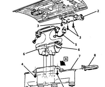

1993 Chevy Beretta 4 cyl Front Wheel Drive 145000 miles
I think my coil went bad however I'm not sure where it is located can you advise?

How do you know its the coil pack-Did you performed a spark test? If you know what's a sparkplug follow the sparkplug wires from it towards the side of the engine this is where the coil packs are.

Hello, do you have IDI ignition, I'm not sure of the litre size of your engine? The picture is IDI.
https://www.2carpros.com/forum/automotive_pictures/170934_IDI_1.jpg
#2 is ignition module
#6 are the coils
#7 is the coil housing
The assembly sits on top of the plugs
If you don't have the IDI system, the plug wire should lead to the coil pack.
