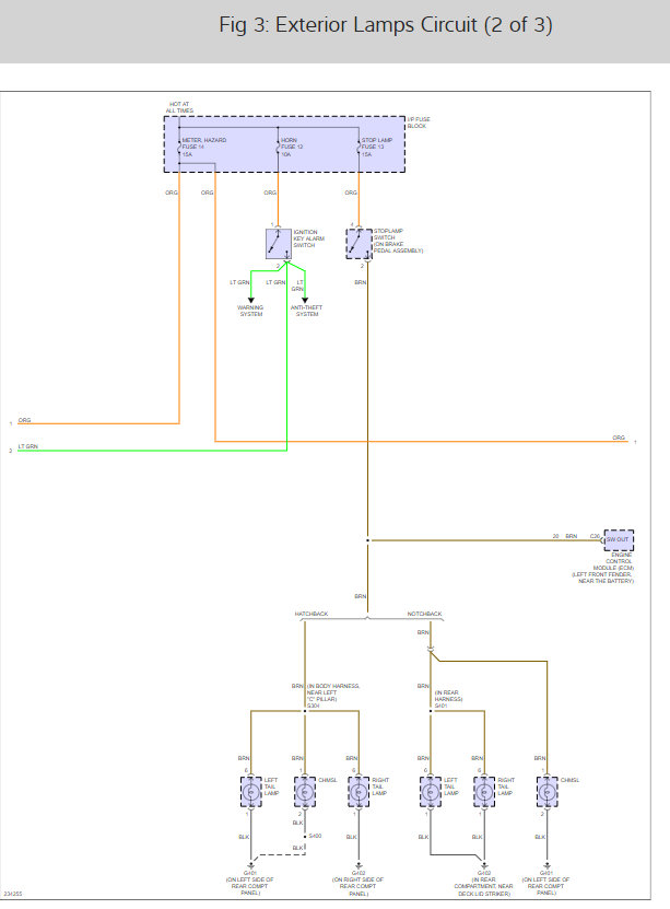

My car has two problems that I think are connected. First; all of my back brake lights do not work, this happened all at once. Second; my car does not register that I have pushed down on the brake pedal so it does not shift out of park unless I push a key into the shift lock release slot on the gear box. This started about a month ago. When I do push down and try to shift it, it just makes a clicking sound on the steering column. Any suggestions on what it could be? Possibly fuses?

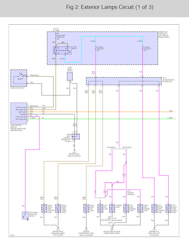

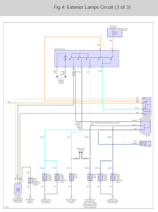

It sounds like a wiring problem. Here is a guide to help you check the wiring:
Here are the brake light wiring diagrams, but I do not see a relay do you mean brake light switch?
Here are the brake light wiring diagrams so you can see how the system works.
