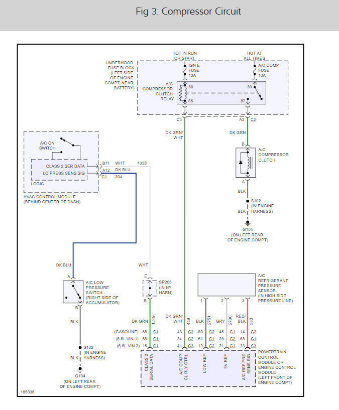

When I start the truck in the morning the a/c works fine for a while or till I turn off the vehicle. Sometimes it will come back, sometimes it won't. Is it a climate control problem that most avalanches have or a pressure switch?

This is common when the system is low on charge or the compressor clutch needs to be replaced. This guide will help us see whats going on.

No leaks, charge is good (44psi when comp is running), no codes showing when scaned. I tried changing out the compressor relay. This is what has me baffeled and thinking it's something in the climate control.

I have seen where the AC compressor clutch coil shorts out and not allowing the compressor to engage. Some of these you can just replace the coil but others you must replace the compressor.
When the ac is not working take a test light and see if the compressor is getting power if so the unit is bad and needs replacement.

I have been trying to diagnose my a/c system problems for a few days now with no luck. When I start the car in the morning the a/c clutch engages and the system cools fine for 20 minutes or so. When the car warms up however the clutch will disengage, sometimes it will come back, sometimes it wont. It has gradually gotten worse where it stays off longer to now it wont come back at all most times. I don't know if it is a digressive problem or if it is just because it getting warmer now that we are in summer. I have replaced the low side and high side pressure switches. I have also drained the system down and vacuumed the system, no leaks, and recharged. When the clutch is engaged and the compressor is running the truck cools great. The problem seems temperature related. Is there a temperature probe that could be faulty? I know the a/c usually cuts out at wide open throttle so I thought the tps could be bad but this truck has electronic throttle control. I figured if the tps were bad there would be no throttle at all. The car has dual climate control.

When it disengages check for voltage on dark Green wire to clutch. If none check at relay underhood box.

Okay got it :) It sounds like the system can be overcharged causing the high pressure switch to kick in shutting the system down. Is the system cold before the compressor shuts off? If so lets check the high side pressure here is a guide to help show you what to do. Also here is the compressor wiring diagrams so you can see how the system works.
