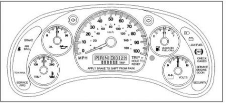

JDL
  • 16,098 POSTS
https://www.2carpros.com/forum/automotive_pictures/170934_security_1.jpg
You see the word security on the lower right of the picture? That's it, if the lite stays on or is flashing, when you try to to start, there is a problem with the theft system. When you turn the key on, no crank, that lite should go out in 4 or five seconds. If the lite stays on, wait before you crank, see if the lite goes out, it may take several minutes.
You could try some of the basic tests, I mentioned.

RICARDO1954
  • 5 POSTS
Thank you. Im not sure what happened but I went out again and turned it on. The light went off after about 4 seconds. I still waited about 10 minutes before trying to start it. It was rough at first but it started. I hope it doesnt happen again. Thanks again for your help. I dont know how this ranking thing works with your web site but you deserve the highest rankings I could give you.

I'm glad you got it started, but, I'm still suspicious about your problem. Right now, it doesn't sound like the theft system.
