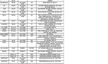

Although I did run but hard to start when hot, I had a cam position sensor code so I replaced the cam sensor and no it won't start. I put the old one back and it still won't start. I went and got another cam sensor still nothing. The engine fuse for that circut keeps blowing. I traced it to a shorted heated O2 sensor and replaced it the fuse no longer blows but he ignition relay gets warm very quickly. Replace ignition switch, coil, moduel, map sensor, throttle position sensor, computor ad still no start. This all started will I was cranking to line up the open notch in the destributor to remove the cam sensor. I pulled the whole engine harness and found nothing wrong?

I didn't see ignition relay? Which fuse was blowing? Do you see anything in the picture that you recognize? OK, I did find a upfitter ignition relay, not sure what circuits that controls, unless trailer wiring harness?
