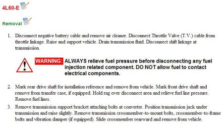

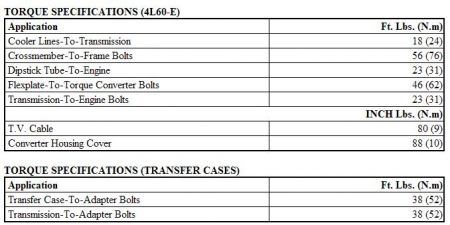

1995 Chevy Astro procedure for transmission removal
BOBARINO
MEMBER
1995 CHEVROLET ASTRO
Transmission problem
1995 Chevy Astro 6 cyl Two Wheel Drive Automatic
what is the process for taking out transmission on 95 astro van
Monday, September 7th, 2009 AT 9:43 AM
BLUELIGHTNIN6
MECHANIC
16,542 POSTS
+1
Monday, September 7th, 2009 AT 10:35 AM
