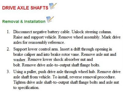

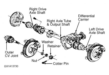

I would like to know how to replace the passenger side front axle of my 1994 chevy astro AWD. Thanks.
