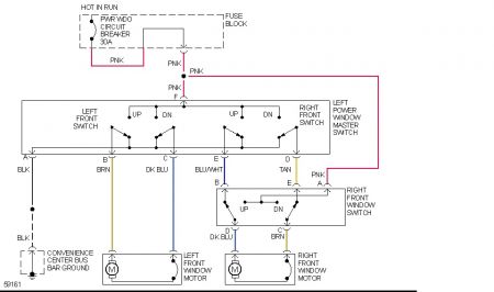

1991 Chevy Astro power windows
JOEL BEESLEY
  • 1991 CHEVROLET ASTRO
  • 6 CYL
  • AWD
  • 150,000 MILES
The power window on the passenger side will go down but not up.
Sunday, April 18th, 2010 AT 5:48 PM
INTERNETMECHANIC
  • 700 POSTS
Did you try the master switch on driver door, as well as the switch on the passenger door? As you can see from the diagram, the voltage to the passenger window motor does not go through the master switch, when using the passenger side switch, but the ground does. You might be able to access control wires, hinge side of passenger door, Sometimes there is a rubber protective boot, covering the wires, you might be able to pull boot back enough to expose and check the proper wires for voltage and ground.
