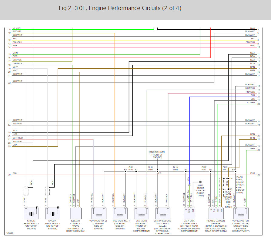

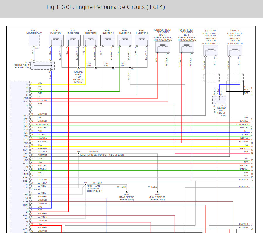

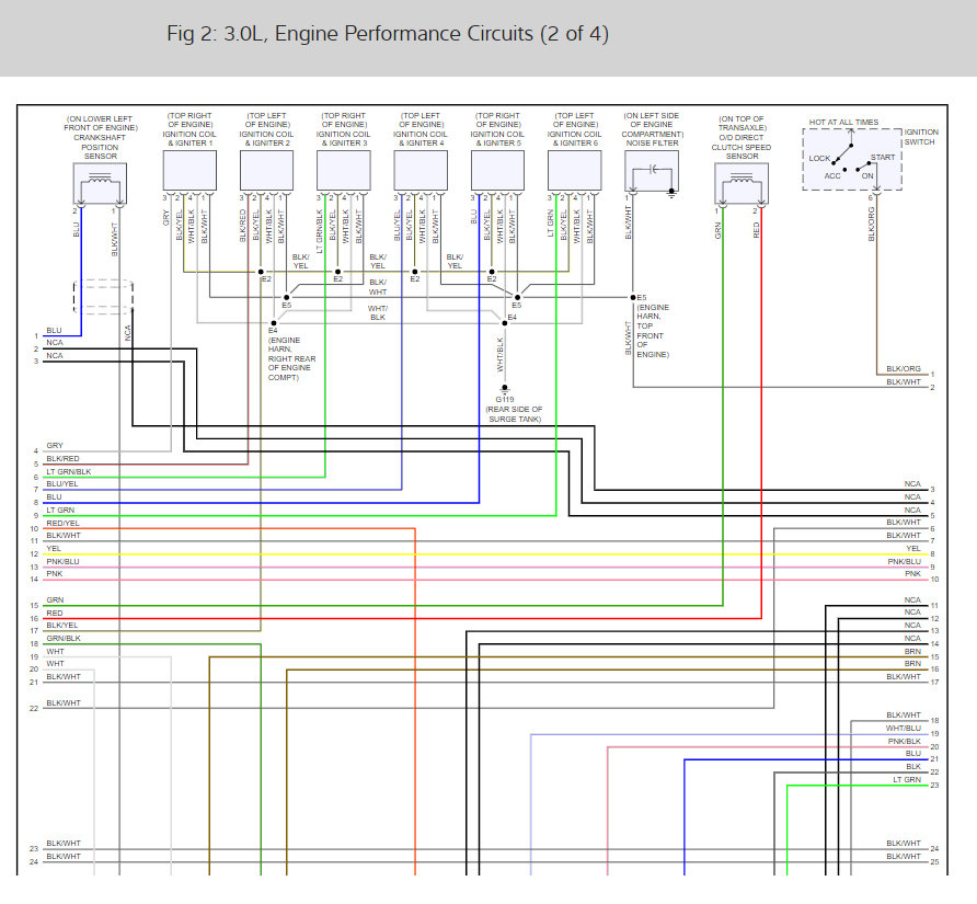

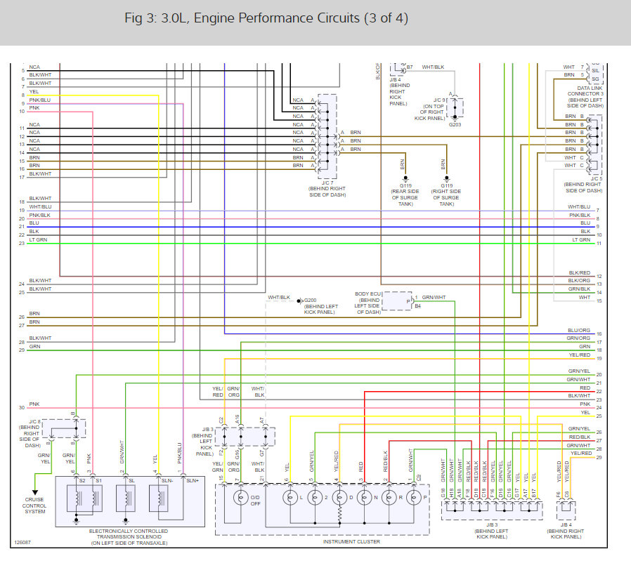

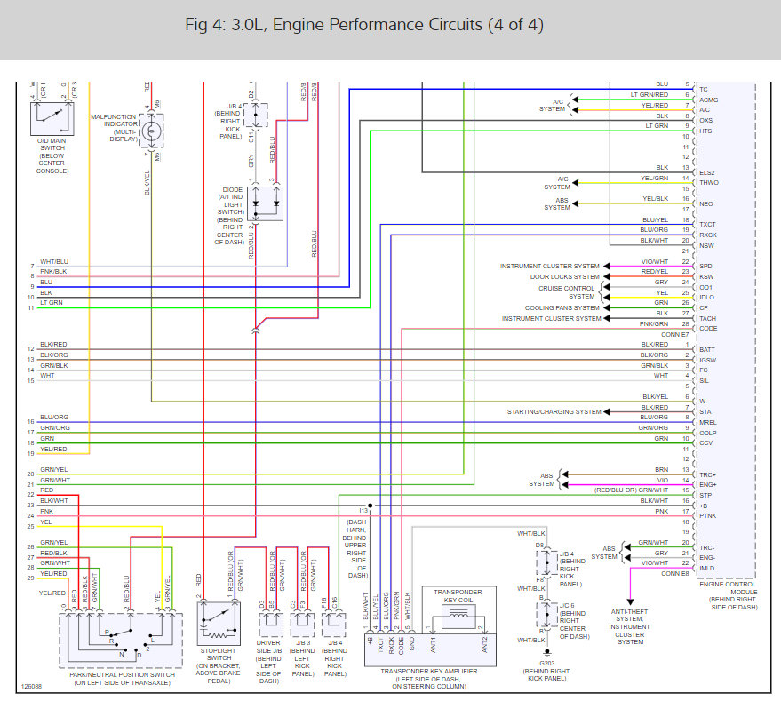

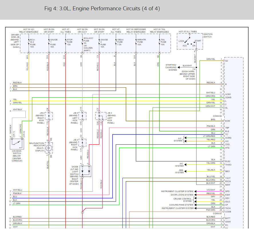

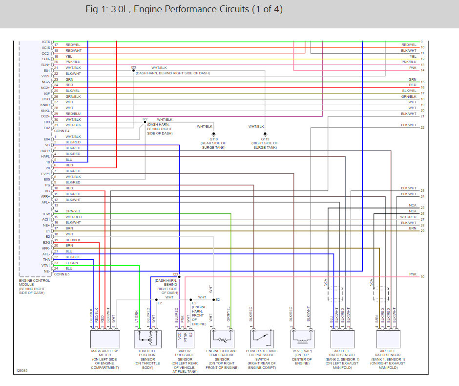

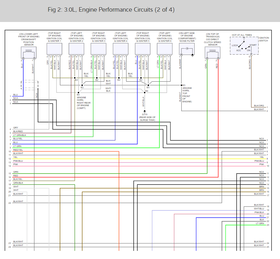

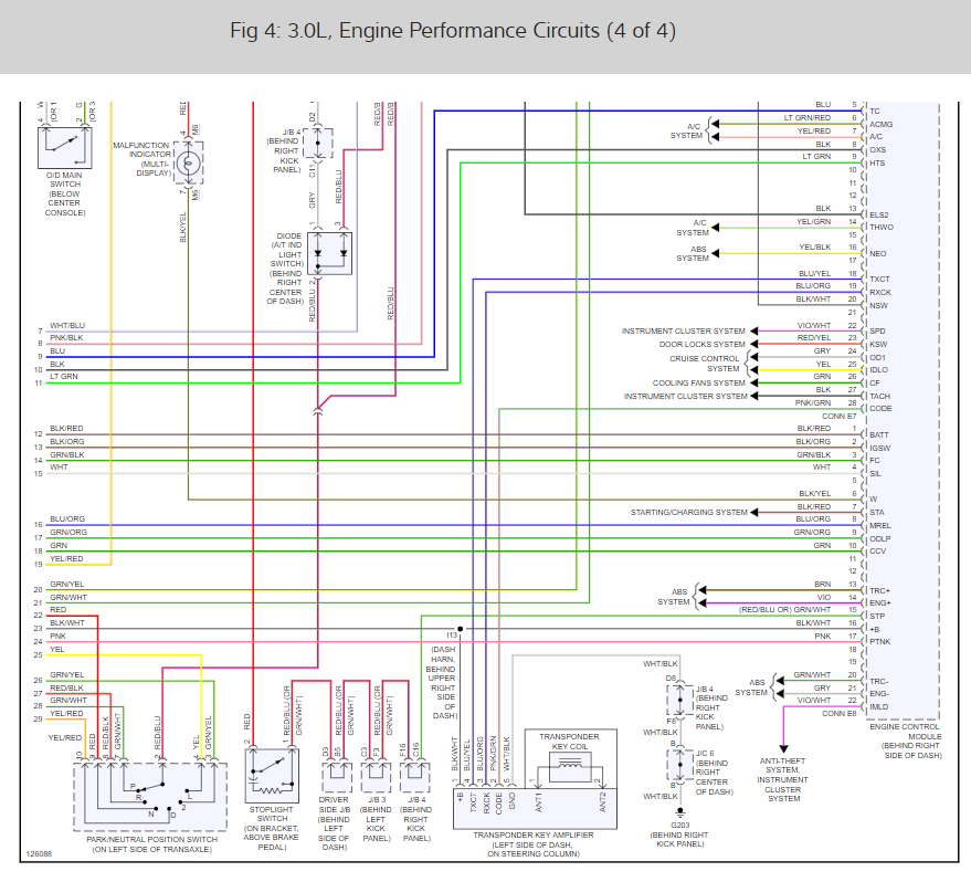

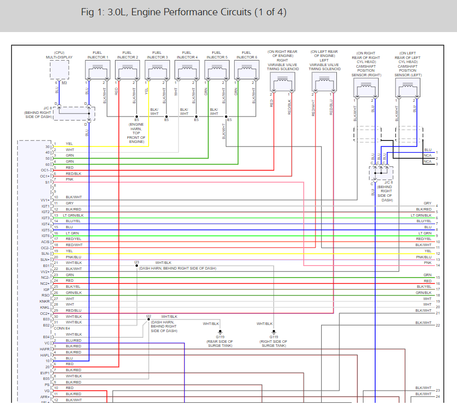

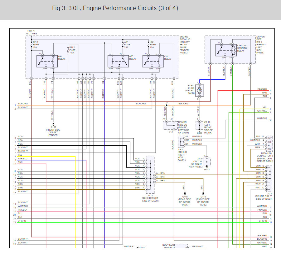

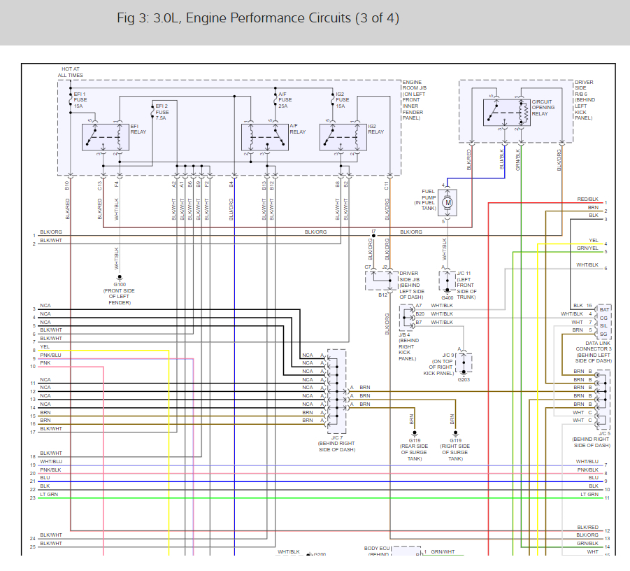

It does seem to have many unrelated problems. I would get a used ECU and plug it in to see what happens or send it out to have it tested. Also we can test the wiring by using this guide and the engine wiring diagrams below:
