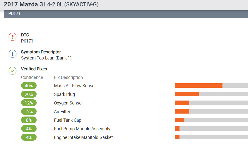

Code P0171, hesitates and has a rough idle?
MAZDA2017
  • 2017 MAZDA 3
  • 2.0L
  • 4 CYL
  • 2WD
  • 72,085 MILES
I can feel it shake and vibrate while I drive. I changed spark plugs and MAF did not really help but the code on the OBD changed to suggest p0171 reinstall air duct intake.
Tuesday, August 30th, 2022 AT 9:29 AM
15 Replies
KEN L
  • MASTER CERTIFIED MECHANIC
  • 55,428 POSTS
Yep, it sounds like you have a cylinder misfire which will cause the P0171 code. Let's remove the spark plugs and do a compression test. Remove all spark plugs and this guide will should you how:

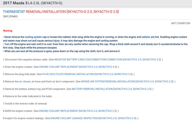

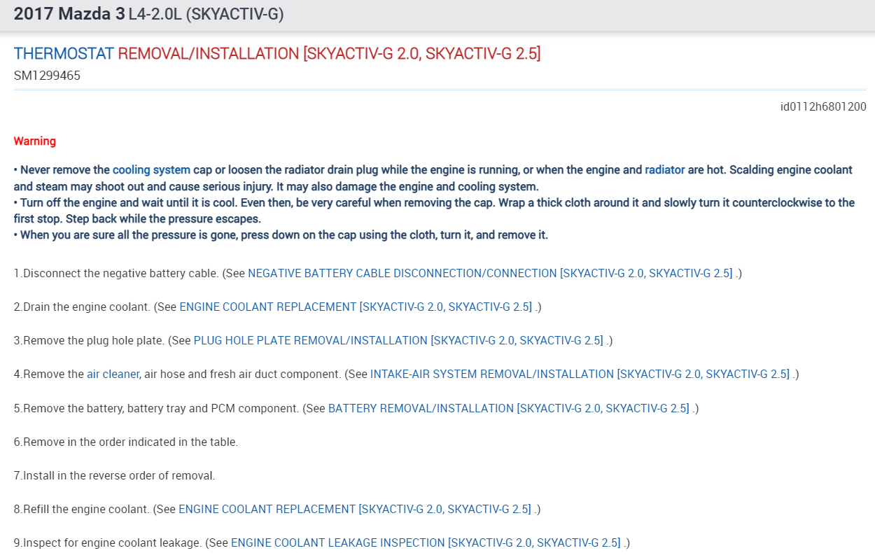

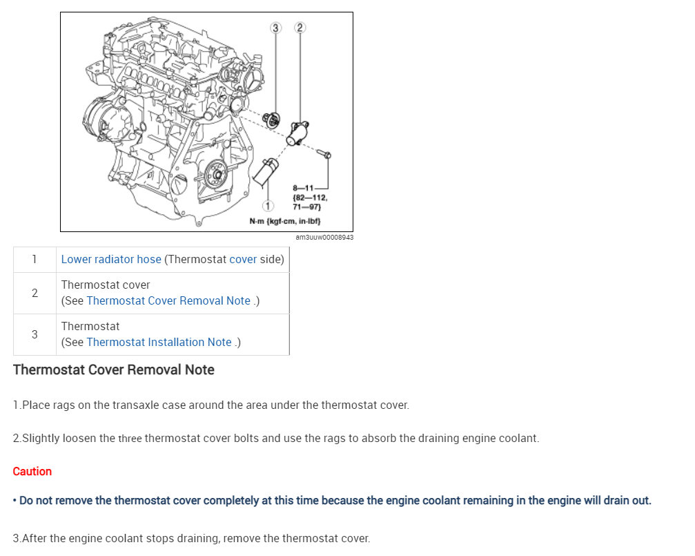

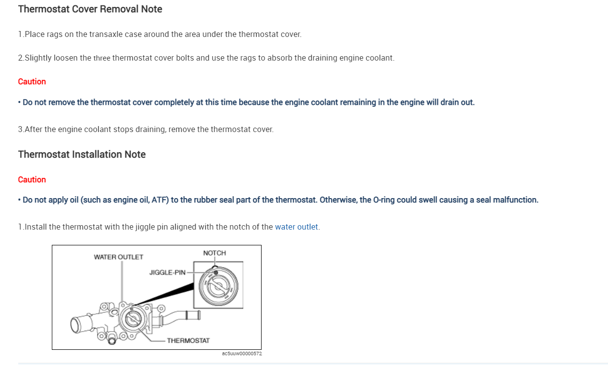

KEN L
  • 55,428 POSTS
P0171 System Too Lean to the overheating problem will not affect this. Have you tried to replace the thermostat?
Here is a generic guide so you can see what you are in for with instructions for your car in the images below:
And this can help as well:
https://www.2carpros.com/articles/engine-overheating-or-running-hot
Tuesday, September 6th, 2022 AT 6:05 PM

KEN L
  • 55,428 POSTS
When you remove the thermostat, drop it into a pan of boiling water, it should open quickly. Yes, before you begin drain the coolant out of the system to minimize spillage.
