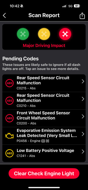

I got a check engine light with five different codes on my car listed above, I haven’t noticed any performance or driving issues such as weird noises and I am not sure what these are indicating.

Those are listed as pending codes; you need to look at the active codes. Pending means that something happened to trigger a fault, but it may not be an actual fault unless it happens again withing a time limit. The ABS related codes would normally trigger the Brake warning light and the CEL. The EVAP code would trigger only the CEL. The low battery could also cause the ABS related codes if the voltage was low for a while. At this point I would erase the codes. Then take it for a drive and see if any of them show back up as pending or active codes. That way you are not chasing phantoms.

Good to know, thanks for information. I have cleared the codes and hopefully nothing comes back, will keep you updated!
