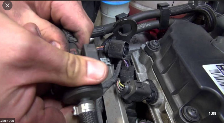

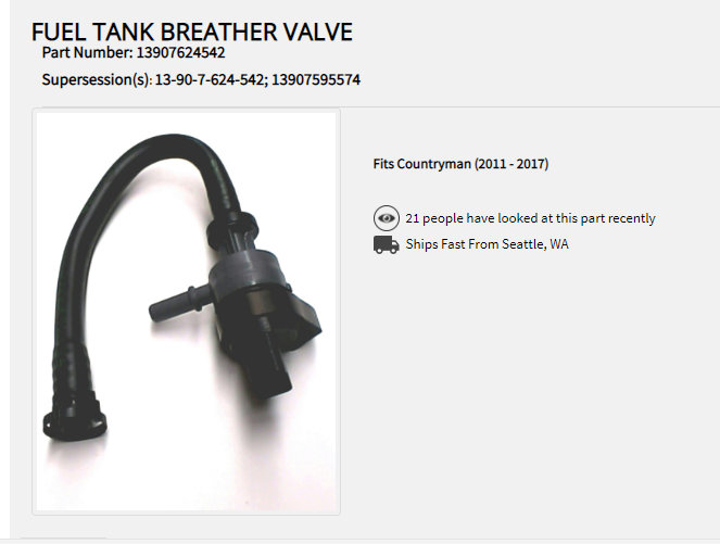

Not really, the P1447 code is for the EVAP system purge occurring when the system is not requesting it, which meant the purge solenoid is stuck on which is common. here is the location of the solenoid so you can check it out and replace it then clear the codes.
Component Location:
The fuel tank ventilation valve is located on the back side of the engine, facing the vehicle bulkhead.
Here is what the valve looks like and the location. Check out the diagrams (below). Please let us know what you find.

Yes, it should be you should see it by lifting the hood.

you can not see it just opening the hood. It is under the air filter box, which must be removed to see and access the valve.
