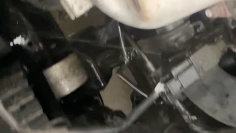

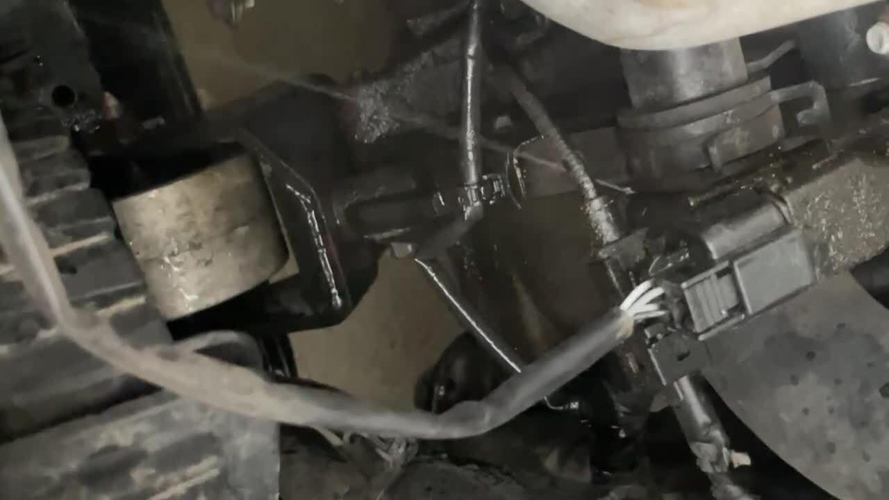

I have read both responses hadn’t had time to check the car it’s self how eve since asking the w questions I've noticed my car sounds louder then normal the cat under the hood has a bad smell of exhaust coming from it an my engine coolant by pass hose that comes off the thermostat to the endgame head is spraying coolant right wheee the clamp holds it on how hard is that to change ??? Also I will upload any pics an videos as I go on your reply’s here’s the coolant leak video an in the video you can kind of see the cat that has the exhaust smell coming from it.

KAYLEEPOE5590
Hose leaking coolant under my engine block.

Yep its a pretty easy fix. Most likely the coolant is spraying out and dripping down onto the cat and the rest of the hot components down there that's where the smell would be coming from its burning the coolant off might smell a little sweet but that should go away once you replace that hose and that should be done right away without hesitation and i wouldn't drive the car anymore until its repaired on that note the good thing is while you're doing it you might find some of the other things i meantime since you be up close in there for a few minutes. hope this helps "good luck "
