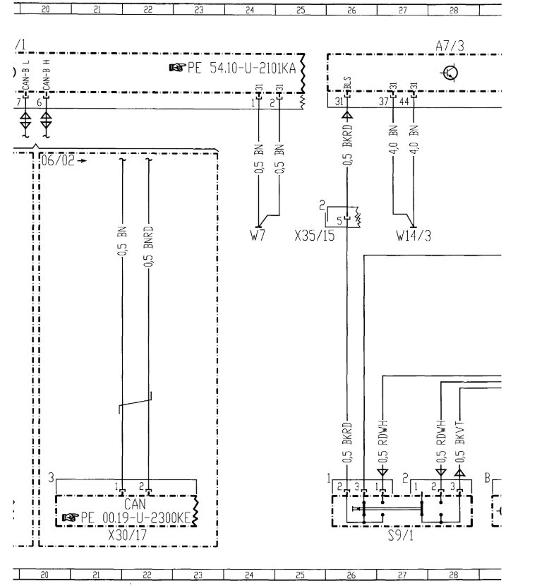

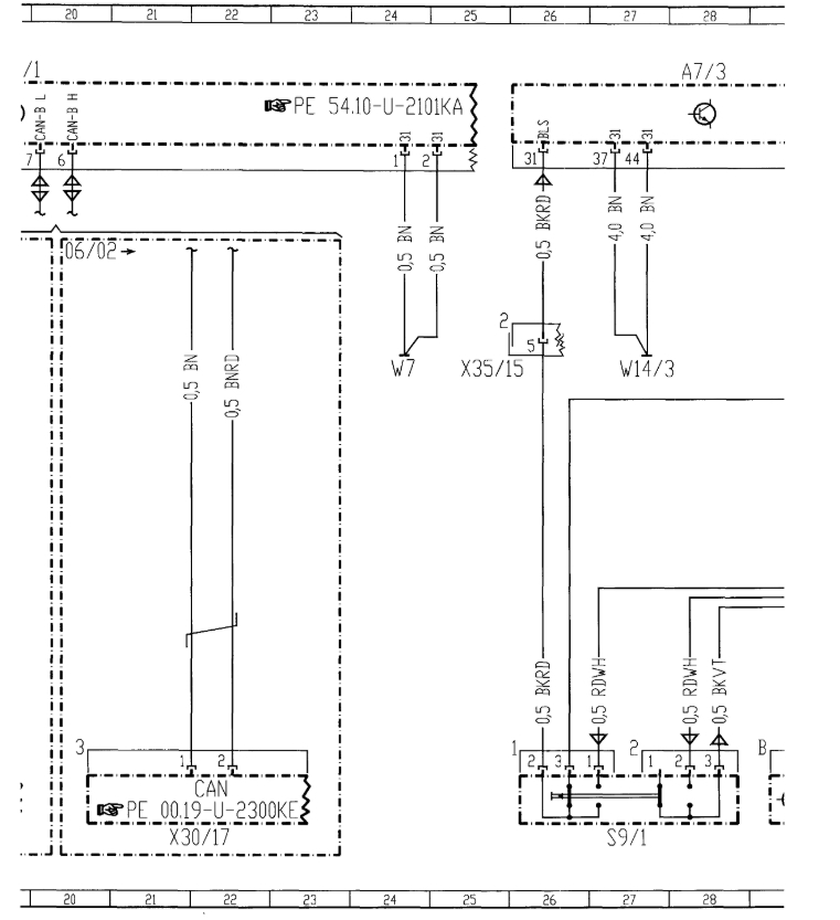

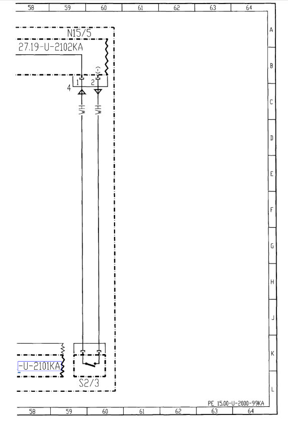

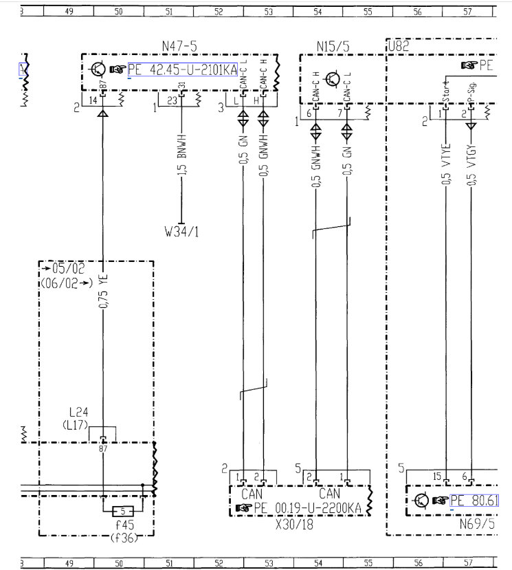

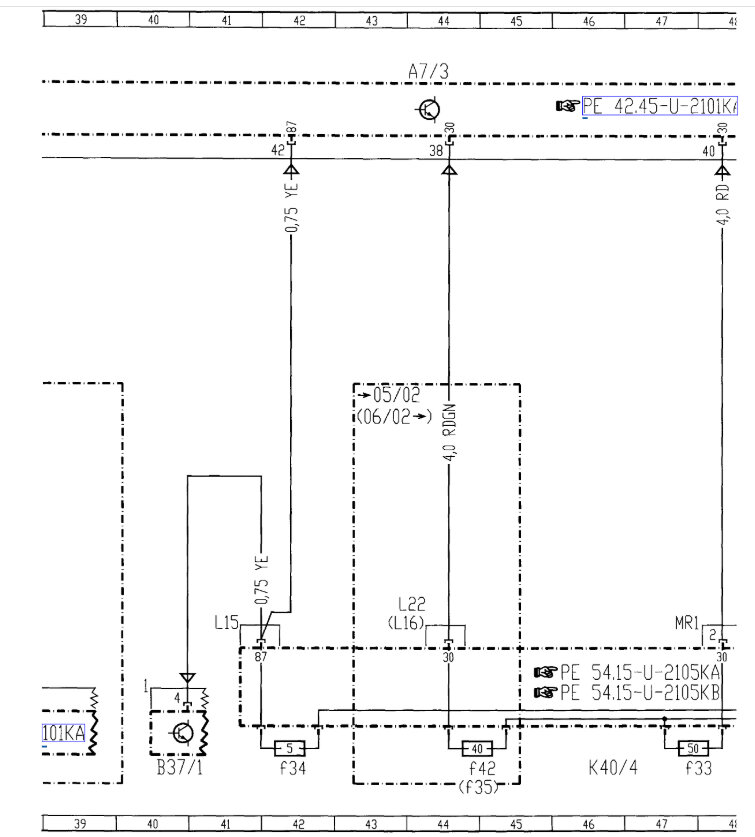

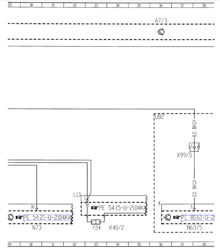

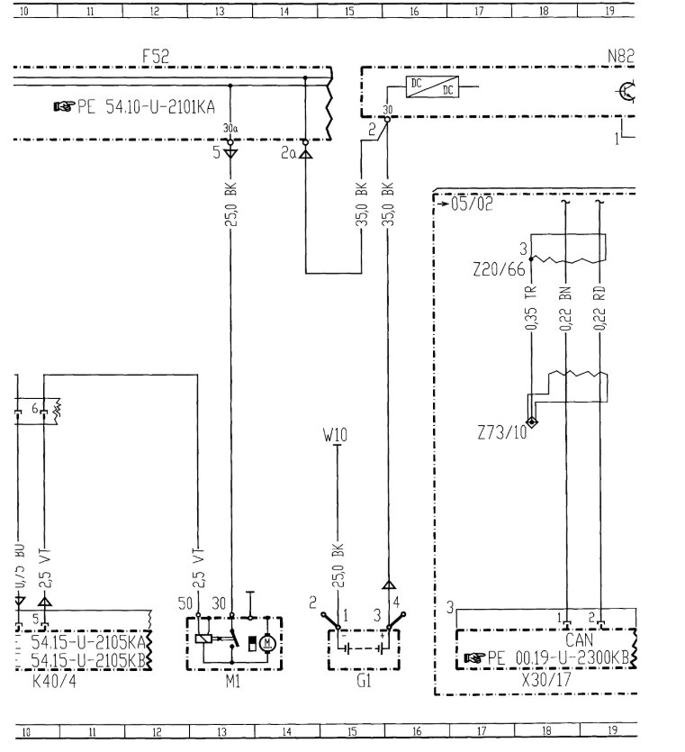

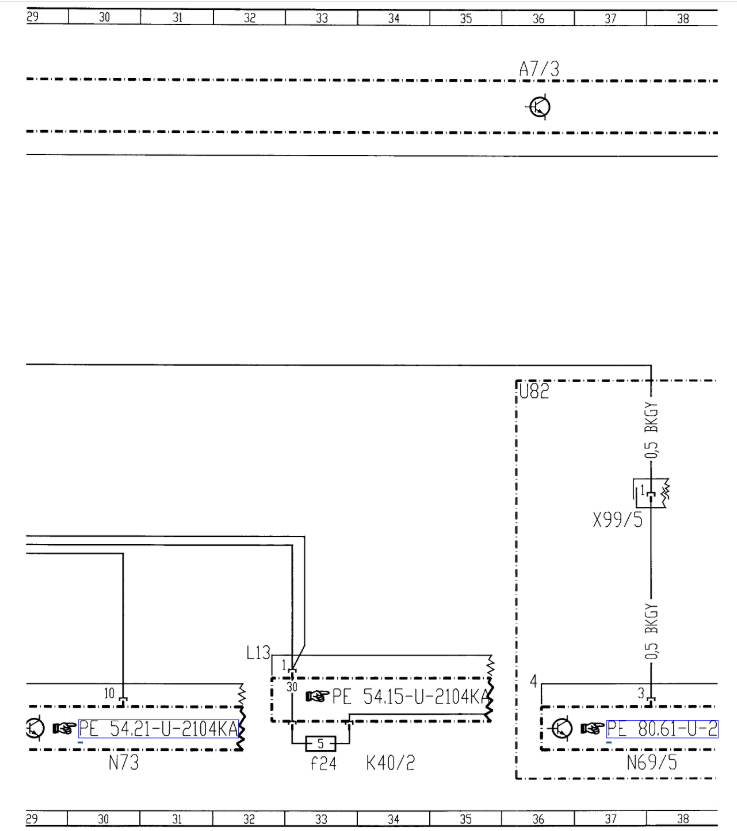

I would start by checking the fuses, here are the wiring diagrams for the charging system, for some reason they are not good quality so you will need to print them out to piece them together to read them.
This guide can help:

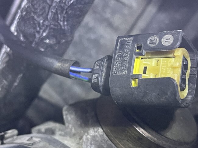

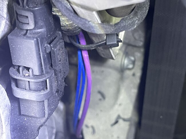

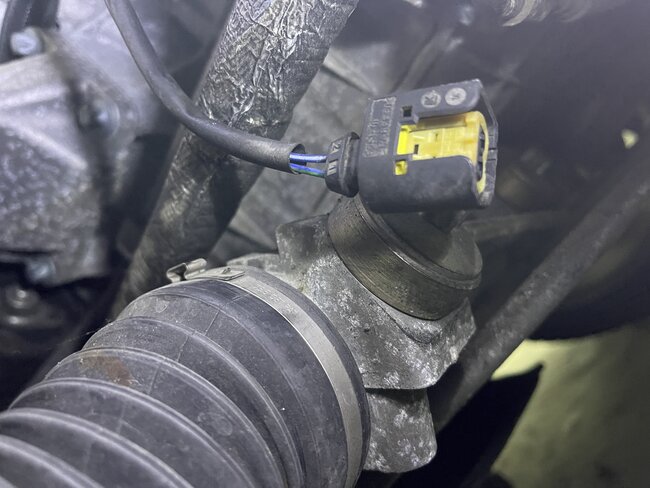

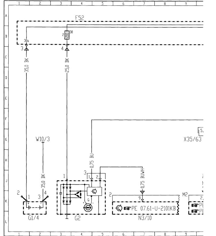

I checked the power cable from behind the alternator and it has power. Checked the 2-pin connector and has no power or ground whether engine off or on. Seems like someone has already tried to check it as the insulation on the wires on top are partially removed. What are these connectors supposed to have? Ground and power? And anyways u can find out which fuse is responsible for it?

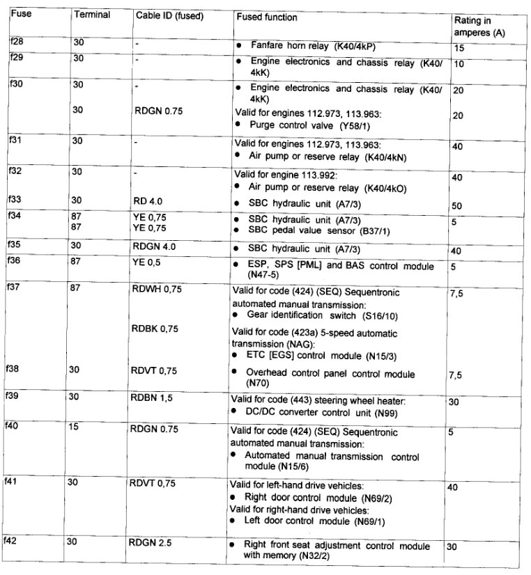

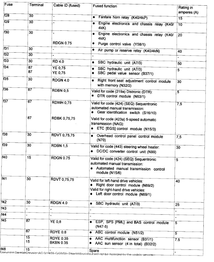

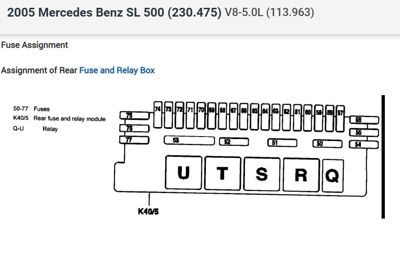

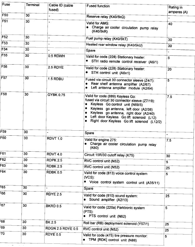

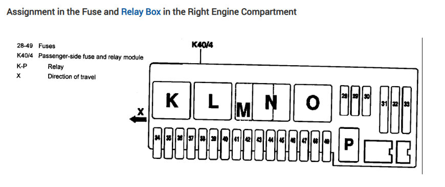

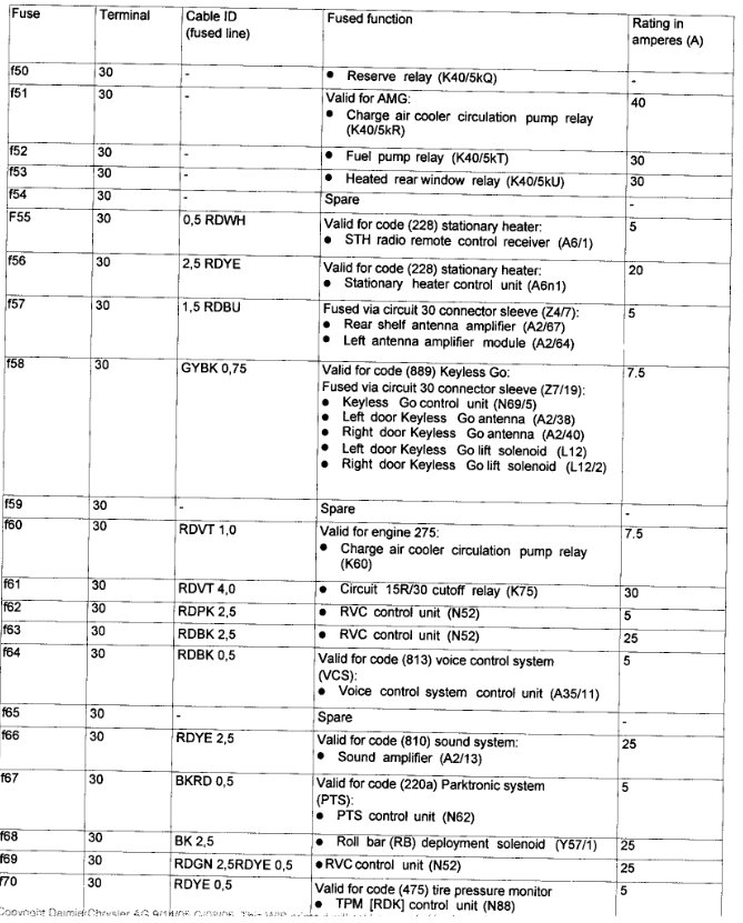

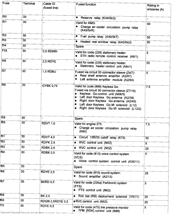

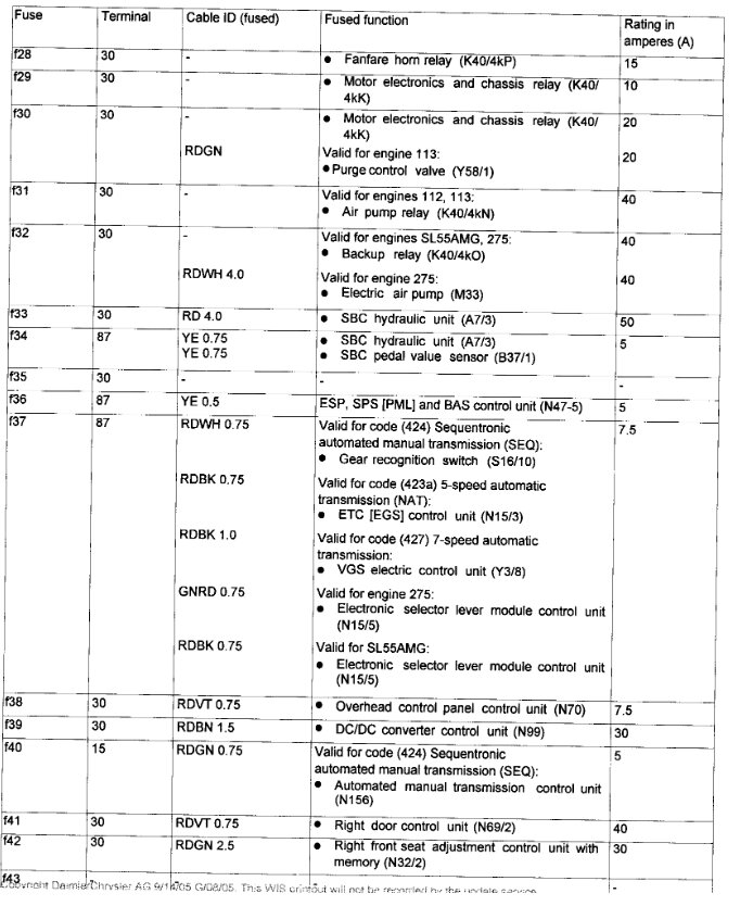

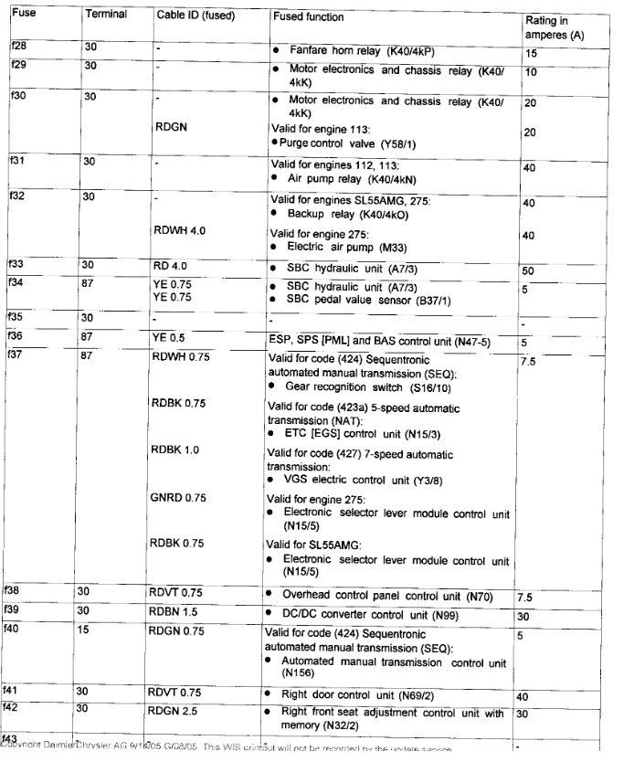

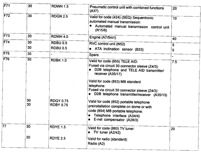

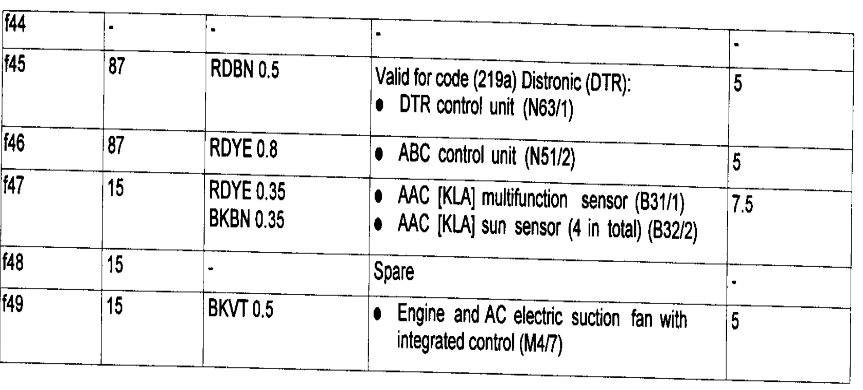

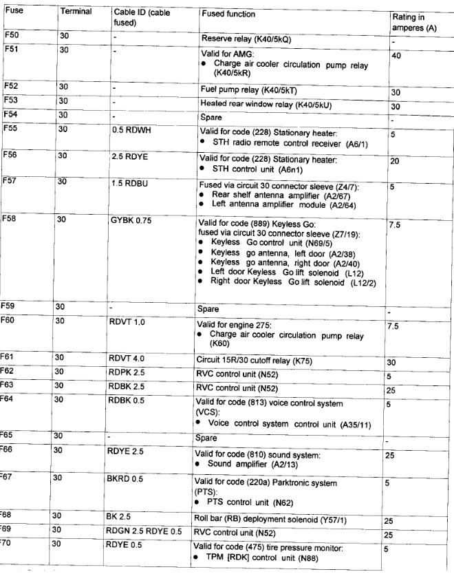

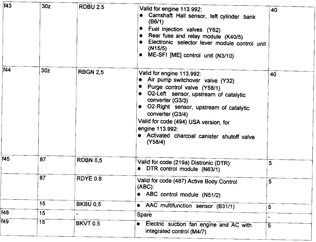

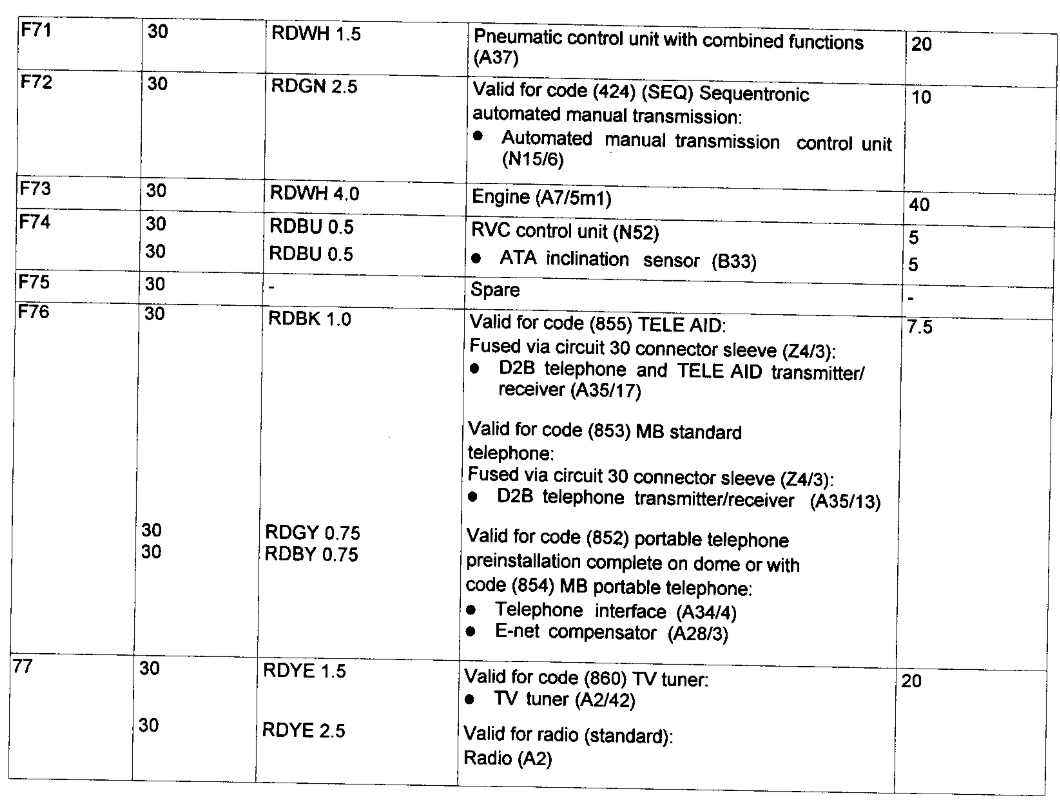

My information for this car is limited for some reason. Mercedes does this sometimes on their high-end cars. Here are the fuse and relay locations and what they do. Check out the images (below). Please let us know what happens.
Nov 26, 2024 at 11:38 AM
BHAMDOC1973
  • 2,007 POSTS

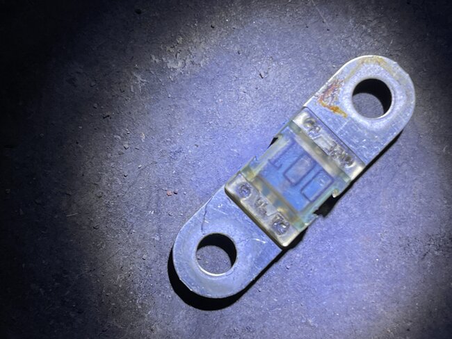

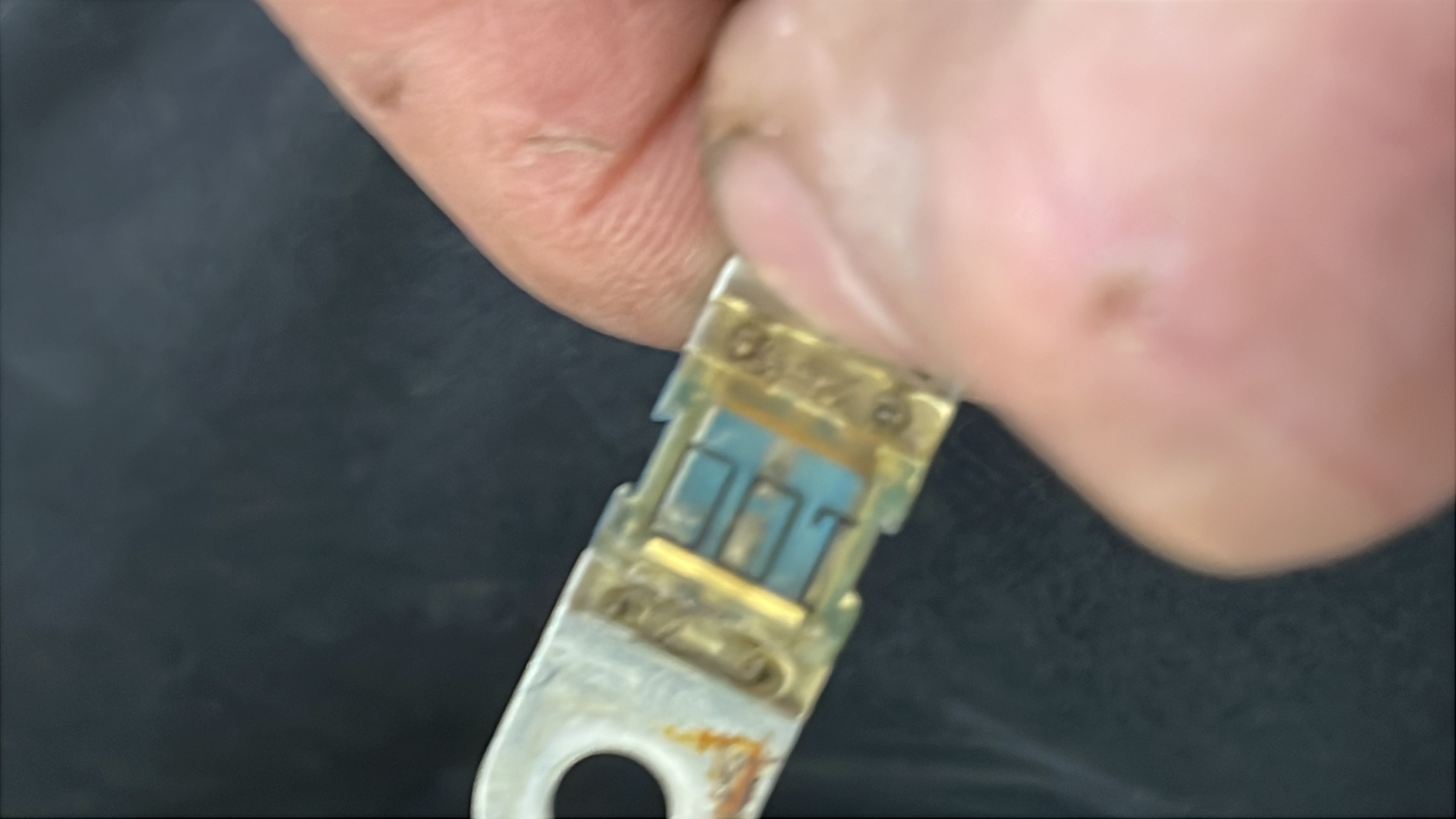

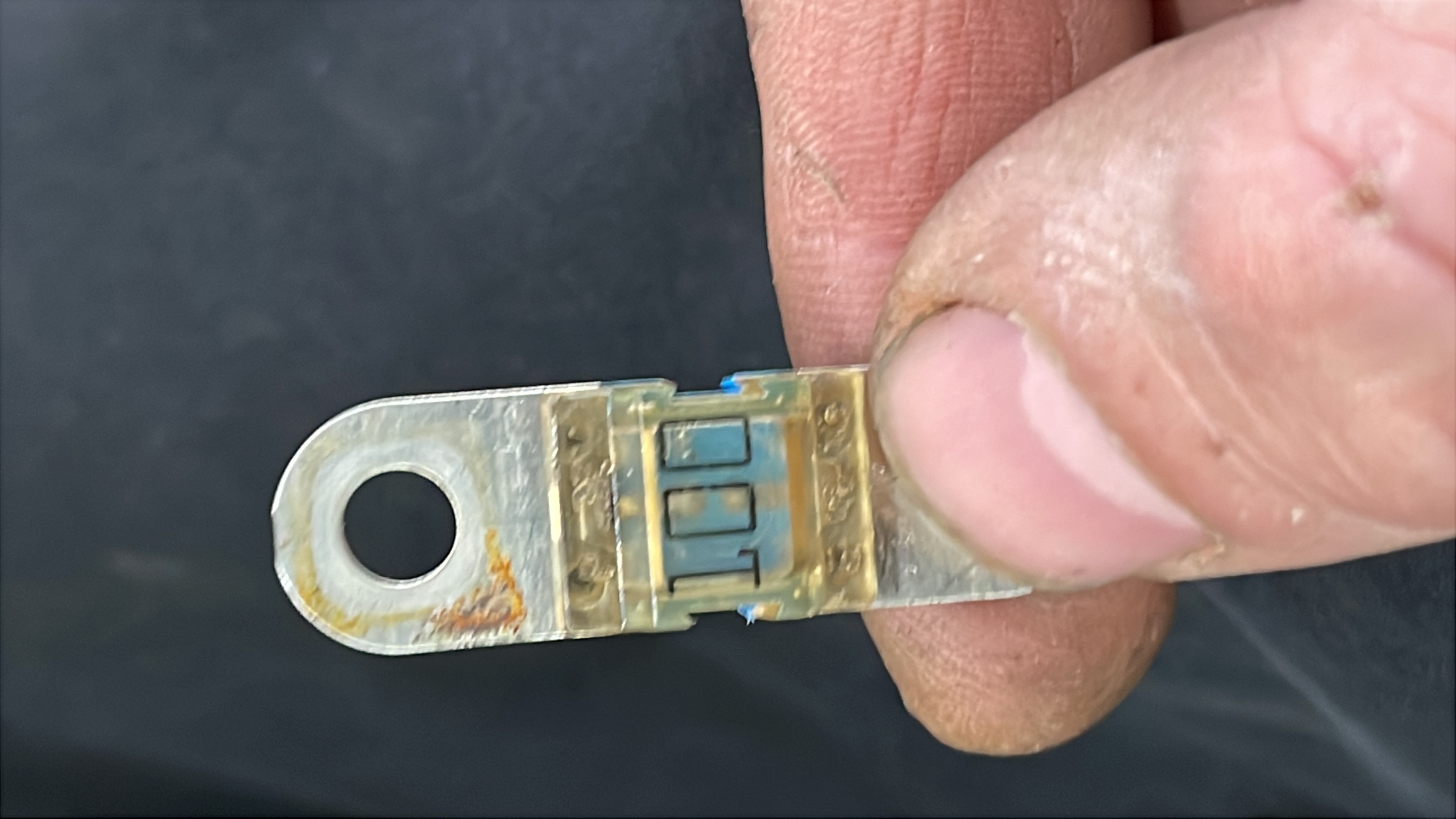

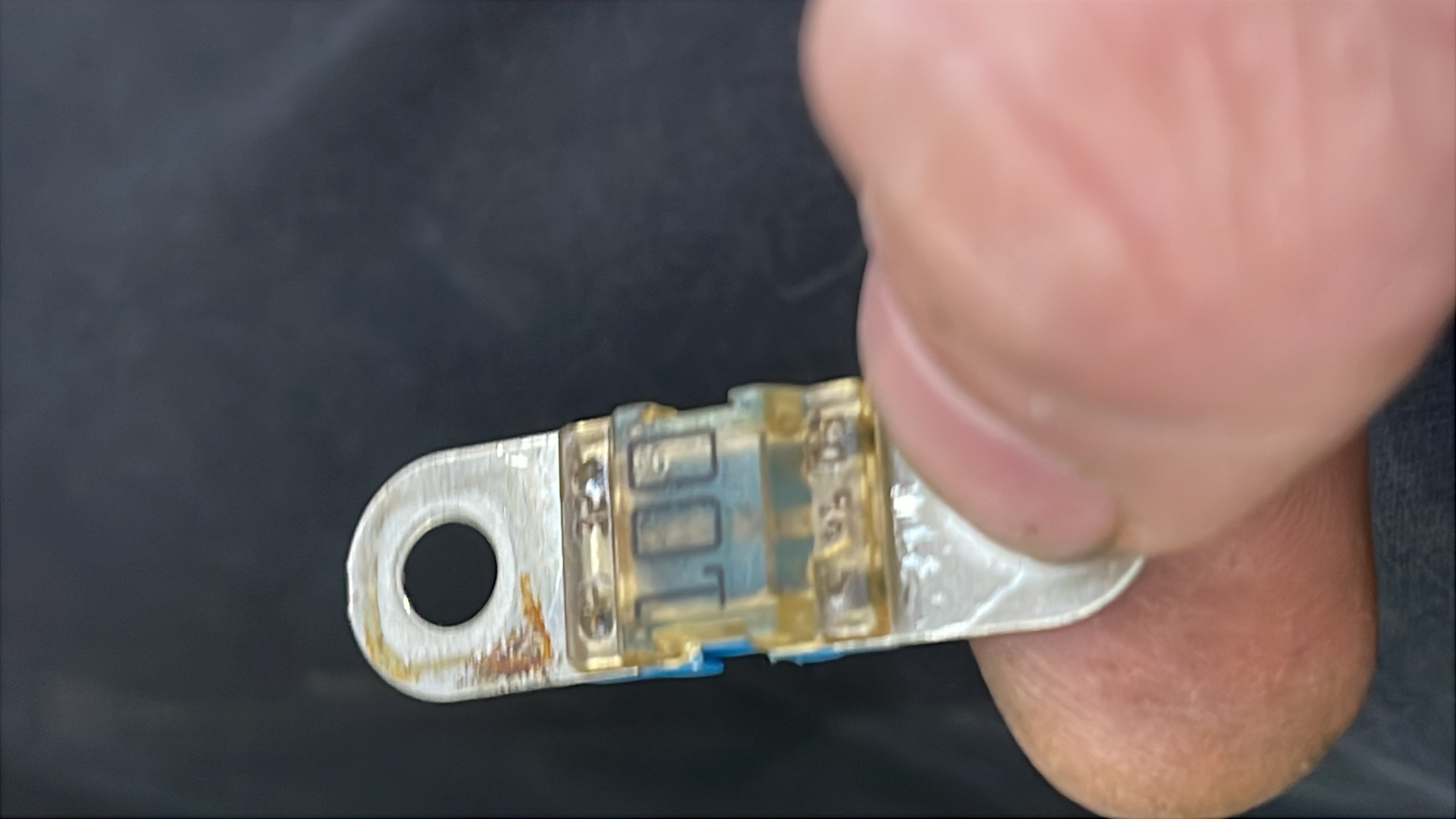

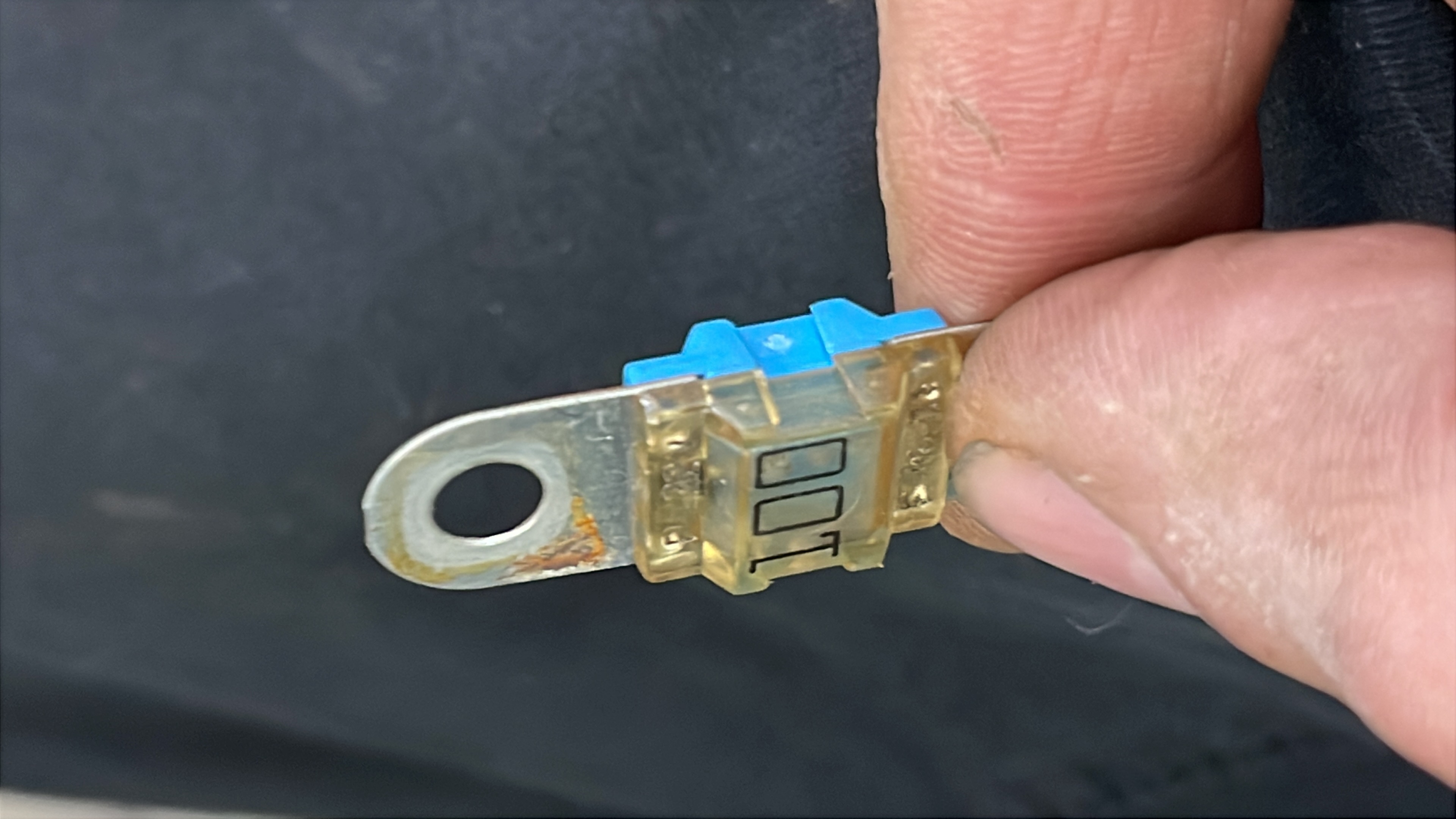

Turned out there was a 100-amp fuse underneath the 200-amp fuse. 200 charges the rear, 100 charges the front, removed it but can't tell if its blown or not. But with my tester light there was power to one side but not the other.
Nov 26, 2024 at 11:58 AM
BHAMDOC1973
  • 2,007 POSTS
I tested continuity with voltmeter and didn't beep. Hopefully its done. Hard to see if its blown. Just out of curiosity why would something like this blow? Voltage too low? Battery weak?
Nov 26, 2024 at 1:00 PM
BHAMDOC1973
  • 2,007 POSTS
Also, do you think something like this when blown could affect other electronics not working in the car?
Nov 26, 2024 at 1:02 PM
  • 54,520 POSTS
Yes, the 100 amp fuse is blown which can be caused by a weak or shorted battery. Lets replace it and put the car back together to see what happens.

The fuse fixed the charging issue and battery light. Thanks
