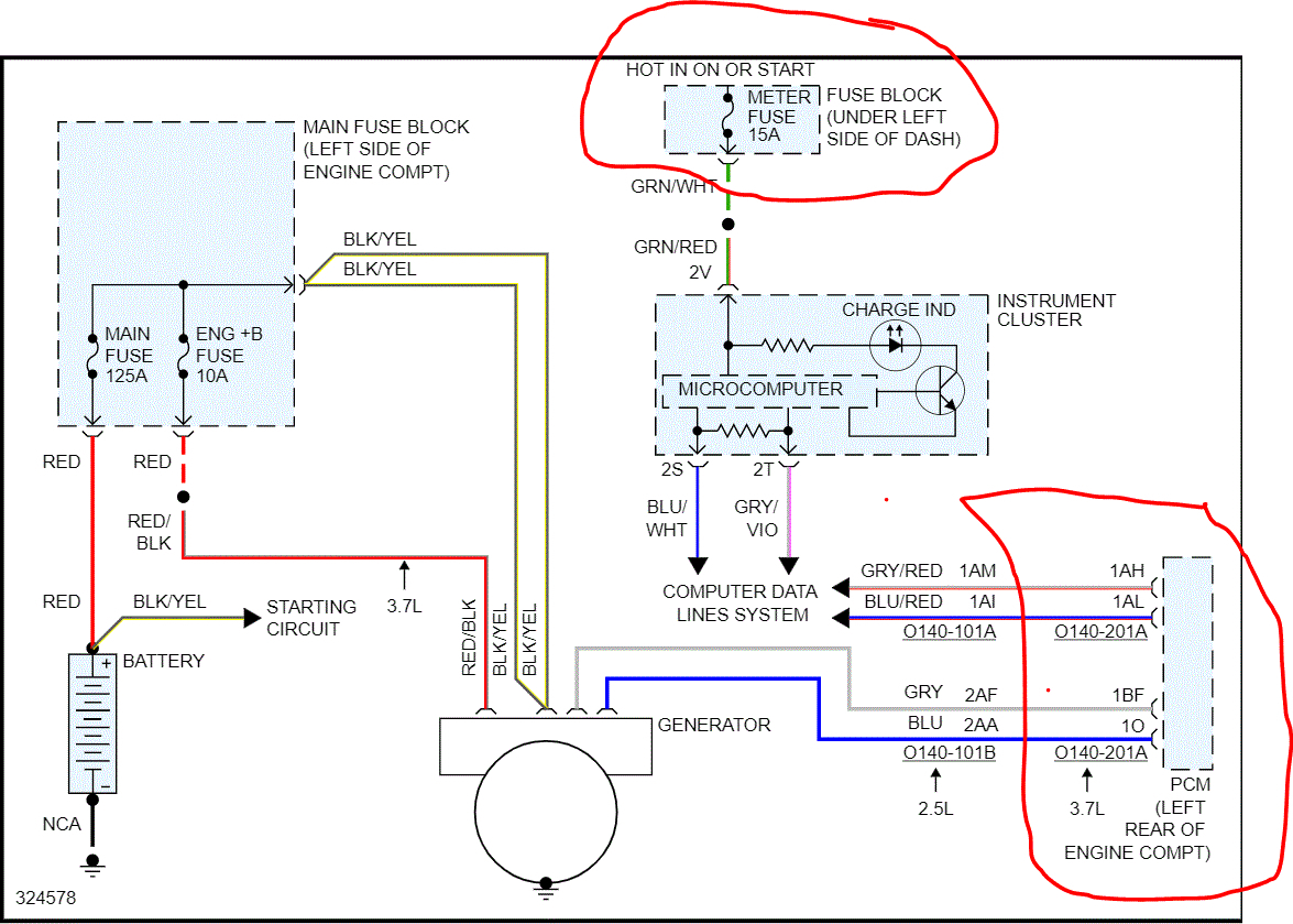

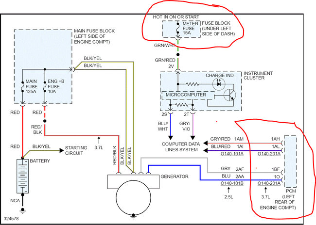

I attached a pic below which is a schematic of the charging system. I circled one fuse I need you to check and make sure it is tight and not corroded. Also, note that two wires run to the power-train control module. Make sure that connection is tight and clean as well.

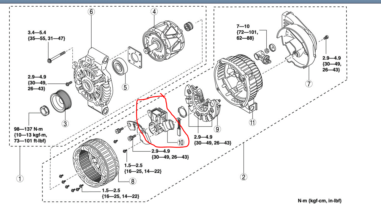

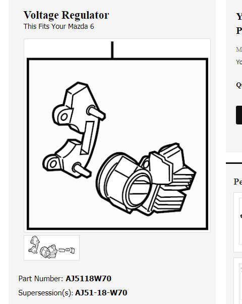

Also, the regulator is built into the alternator. It could be going bad as well. I attached a pic and circled it for you. See pic 2

Checked v with meter 7 sometimes 8.4 and then sit and watch battery light may go off then showing 14.1. Battery went flat while trying to get home before the car shut off. put it on charge v still coming and going,when battery is gone flat all lights are coming on and car is bucking bad.

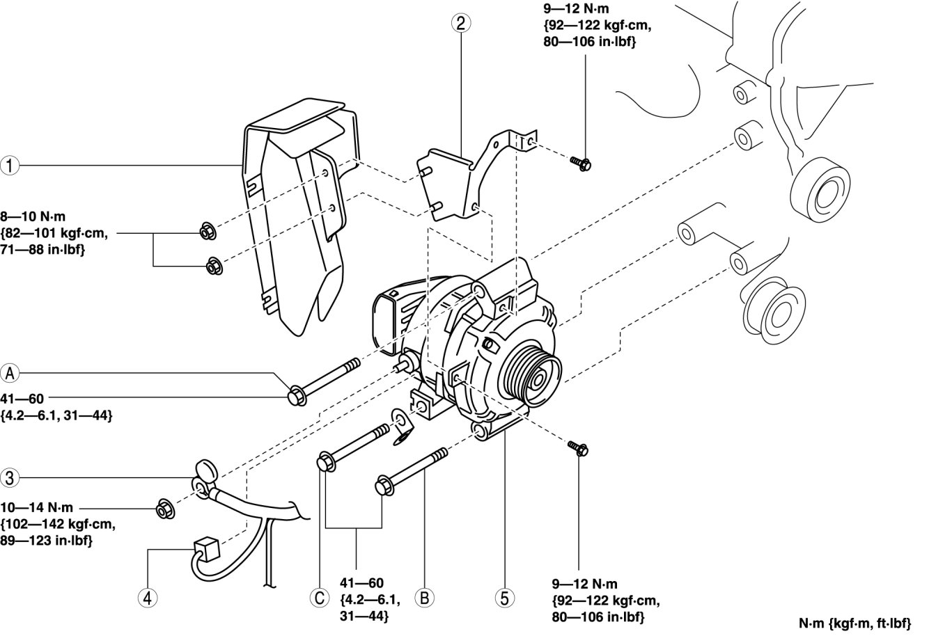

I have to be honest, I really feel the alternator needs replaced. I suspect it was tested by the parts store when the light was off.
Here is a link that shows in general how one is replaced:
https://www.2carpros.com/articles/how-to-replace-an-alternator
Here are the directions specific to your vehicle. The attached pics correlate with the directions.
_______________________________
2010 Mazda 6 L4-2.5L
Removal and Replacement
Vehicle Starting and Charging Charging System Alternator Service and Repair Removal and Replacement
REMOVAL AND REPLACEMENT
GENERATOR REMOVAL/INSTALLATION [L5]
WARNING:
- Remove and install all parts when the engine is cold, otherwise they can cause severe burns or serious injury.
- When the battery cables are connected, touching the vehicle body with generator terminal B will generate sparks. This can cause personal injury, fire, and damage to the electrical components. Always disconnect the negative battery cable before performing the following operation.
CAUTION:
- The generator can be damaged by the heat from the exhaust manifold. Make sure the generator duct is installed securely.

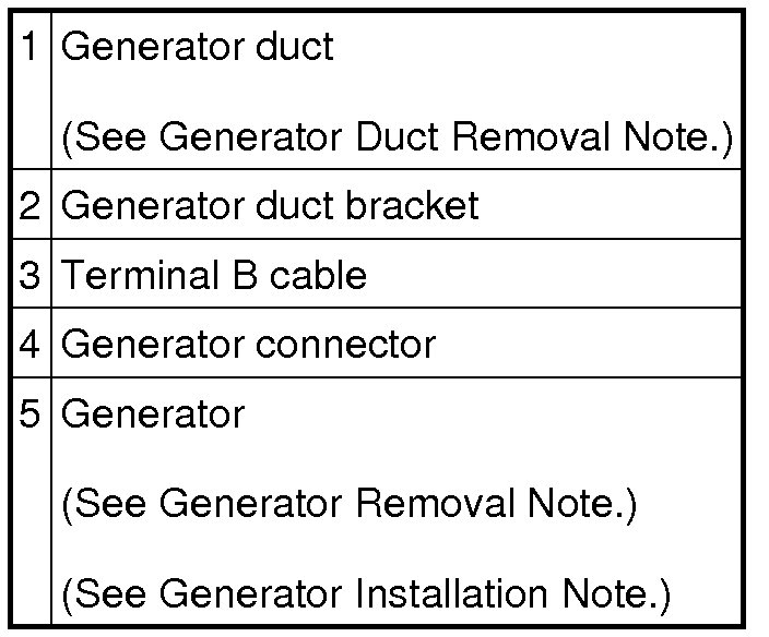

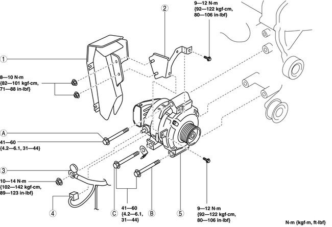

1. Disconnect the negative battery cable.
2. Remove the plug hole plate. See: Access Cover, Engine > Removal and Replacement > Plug Hole Plate Removal/Installation
3. Remove the aerodynamic under cover No.2. See: Splash Guard > Removal and Replacement > Aerodynamic Under Cover No.2 Removal/Installation
4. Remove the drive belt. See: Drive Belt > Removal and Replacement
5. Remove in the order indicated in the table.
6. Install in the reverse order of removal.
pic 1
pic 2

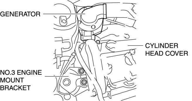

Generator Duct Removal Note
1. Remove the generator duct from above the engine compartment.
Generator Removal Note
1. Remove the generator from above the engine compartment.
pic 3
Generator Installation Note
1. Tighten bolt A temporarily.
2. Tighten bolt B, C to the specified tightening torque.
3. Tighten bolt A to the specified tightening torque.

How did you have the alternator checked? Was it load tested? If so then we need to load test the battery as well.
This light is just telling you that the charging or overall state of charge is below threshold. This could be the alternator, battery, loose belt (as you have suspected) or the voltage regulator is failing not allowing the alternator to charge properly. This is why it is important to be sure it is tested properly. The voltage regulator is most likely the cause of this.
