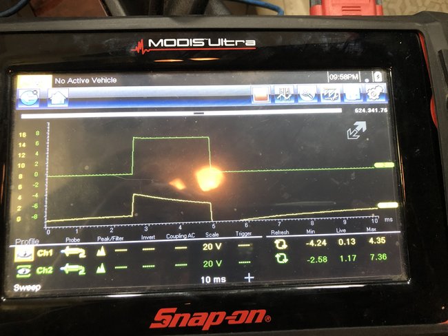

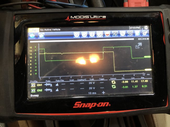

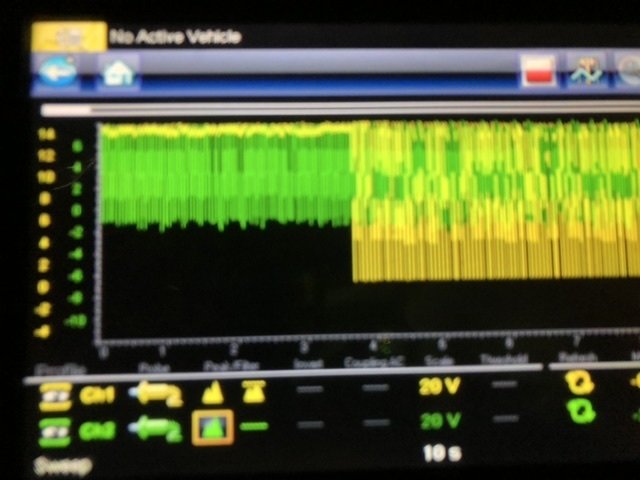

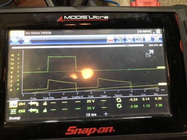

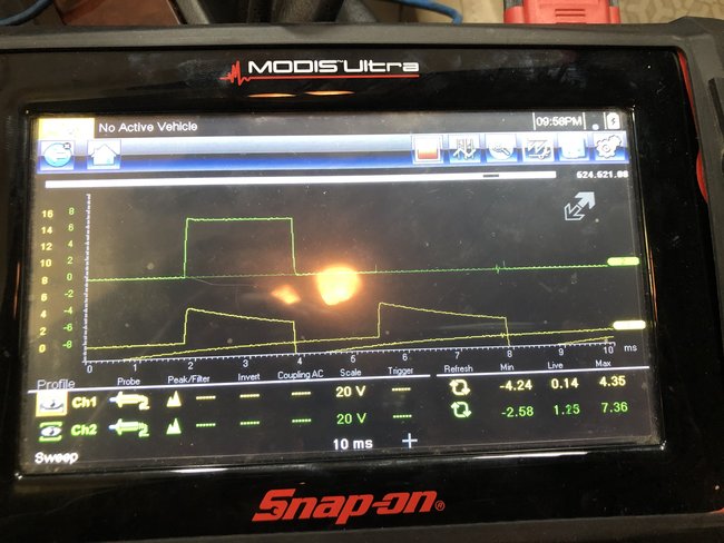

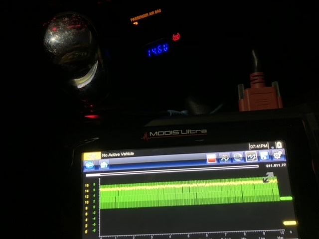

Okay Roy, I got home and set up the scope watching the orange wire (green trace) and the grey wire (yellow trace). The first image is cold start, normal charging. The second image with the yellow drop is the moment it stops charging, and the third pattern is not charging at all. Also, I cleared the codes and picked up a P0621 when the car was restarted.

What is your car information?

2008 Pontiac G6 4cyl. It has the early production charging system.

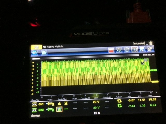

Hi Roy. I solved the p0621. Engine running - the t pin I used to check voltage at the ecm on the orange wire must have shorted to a pin next to it. I had B+ on the orange wire KOEO with the alt unplugged - at the alternator. After the t pin was removed I get 4.01volts. I read that as correct for step 3 in circuit testing. Step 2 was 0.01 volts, I also read that as good. What I have left to figure out is low charging. I reran the lab scope test orange wire + yellow pattern, and it looks more like I would expect. I still drive the battery voltage down below 11 volts at Idle. I get to about 12.3Volts if I turn ALL accesories off. Loads on I slowly drive the voltage down even at 2000 RPM. I will add the patterns from cell in a minute.

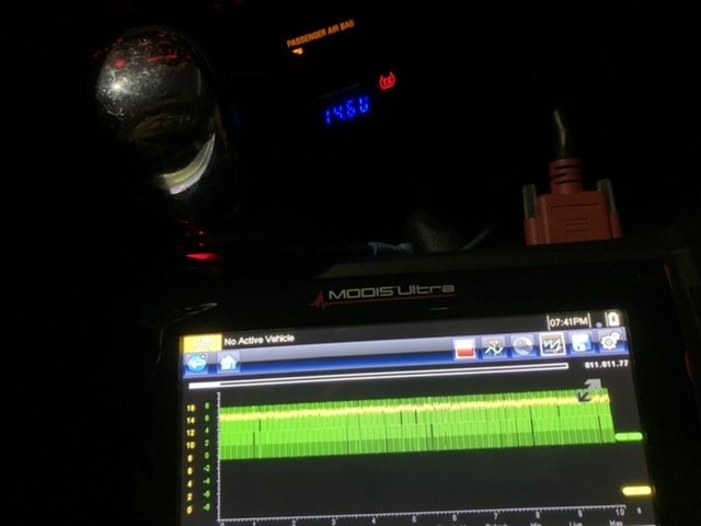

Scope pattern engine running, idle, orange = yellow.
Friday, March 6th, 2020 AT 6:39 PM
Good find. I am concerned that the short you found may have damaged the alternator.

It is hard to tell from here because the pictures are so small.

You can load test a circuit by unplugging both ends, providing 12 volts on one end, a ground on the other end with a load, and checking the voltage drop across your original wire. I use 3 1157 bulbs with both Filaments on to accomplish the load. I had 0.40 volt drop on a loaded circuit. A load pro is nice, I agree, maybe I will look into buying one. I agree that.40 is high, but I have a hard time thinking that it is enough to cause my problem. I can certainly overlay the harness, pin to pin though. Do you think the wave form included looks correct?
Saturday, March 7th, 2020 AT 5:02 PM
JAYJAY3
  • 24 POSTS
Yellow trace is orange wire.
Saturday, March 7th, 2020 AT 5:03 PM
Yes, that is better. Looks good.
