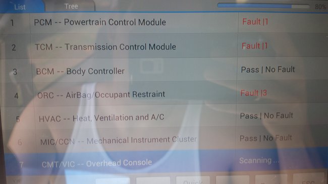

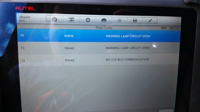

Hi my caravan 99 2.4 wont start I have chage the cam and crank sensor the fuel pump its working, but I have no spark ive change the PCM for other one to test, have the same problem, I use a tester for the coil plug and doesnt have batt voltage. The timing belt its fine the van was working well when I crank the van and let go the switch its make like its gone to start and one time make spark all the relay are working and fuse too the main relay havent been chk

Have desambly the switch cover and no have the immobilazer key reader, its the security system the problem it come in the bcm
