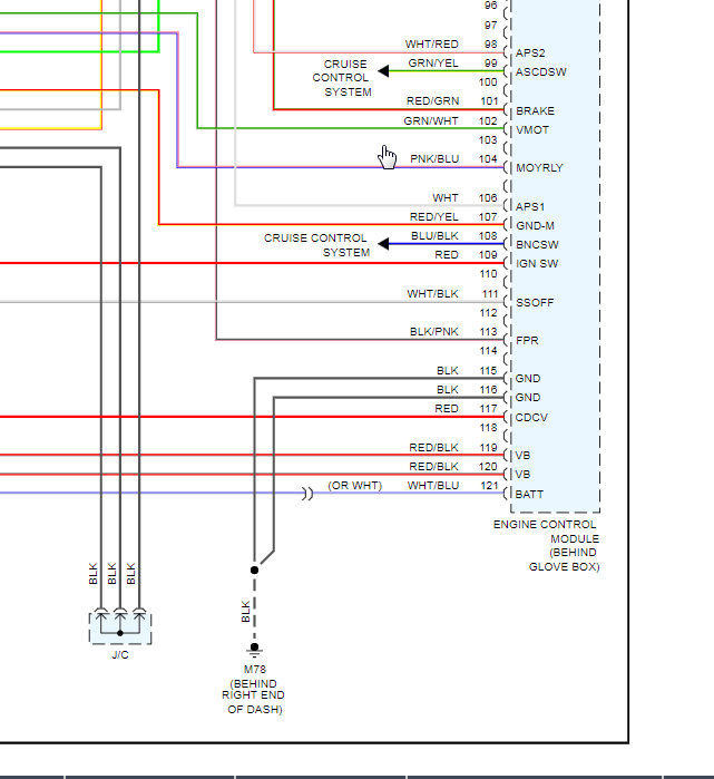

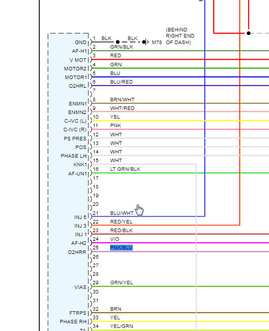

U1001,I have replaced the ECU with part number mec31-140 f1 2y01. i have reprogrammed the immo, the only fault code i have u1001. car would not start. This is the original OEM ECU part number 23710-ca060, it got bad so i replaced. How can i solve the u1001? All ground cables are double checked, i can't figure out where the issue why this car won't light up. Just to add the VIN JN8AZ08T36W412139.

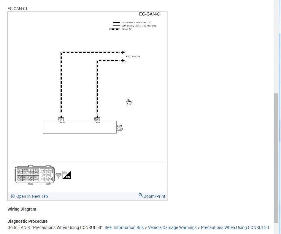

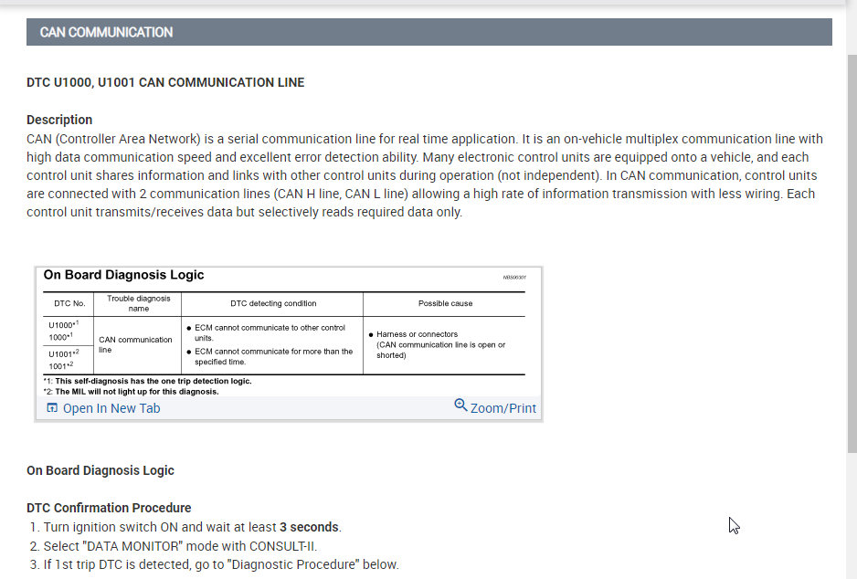

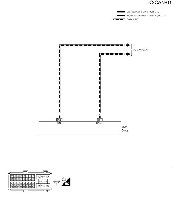

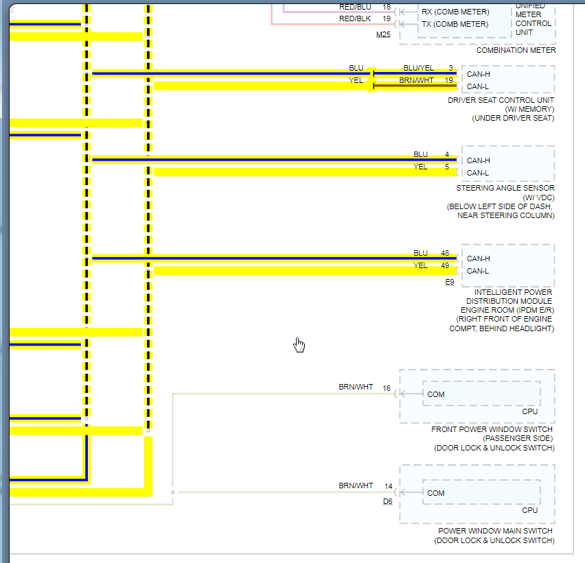

Based on the code, it isn't related to the parts but rather the CAN bus. The modules are unable to communicate with each other. Take a look through this and let me know if it helps. Also, the attached pic correlates with the directions.
2006 Nissan-Datsun Truck Murano FWD V6-3.5L (VQ35DE)
CAN Communication
Vehicle ALL Diagnostic Trouble Codes ( DTC ) Testing and Inspection U Code Charts U1001 CAN Communication
CAN COMMUNICATION
DTC U1000, U1001 CAN COMMUNICATION LINE
Description
CAN (Controller Area Network) is a serial communication line for real time application. It is an on-vehicle multiplex communication line with high data communication speed and excellent error detection ability. Many electronic control units are equipped onto a vehicle, and each control unit shares information and links with other control units during operation (not independent). In CAN communication, control units are connected with 2 communication lines (CAN H line, CAN L line) allowing a high rate of information transmission with less wiring. Each control unit transmits/receives data but selectively reads required data only.
pic 1

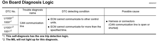

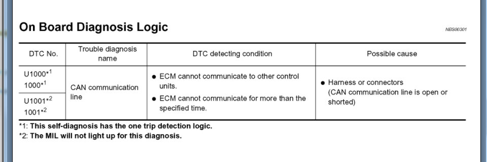

On Board Diagnosis Logic
DTC Confirmation Procedure
1. Turn ignition switch ON and wait at least 3 seconds.
2. Select "DATA MONITOR" mode with CONSULT-II.
3. If 1st trip DTC is detected, go to "Diagnostic Procedure" below.
EC-CAN-01
pic 2
Wiring Diagram

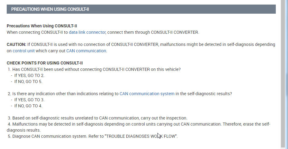

Go to LAN-3, "Precautions When Using CONSULT-II". See: Information Bus > Vehicle Damage Warnings > Precautions When Using CONSULT-II

Just to be clear, this code was not there before you replaced the ECM?
This code is basically telling us that the ECM cannot communicate with the other modules. They communicate on what is called a CAN communication network. Here is a guide that will get us started:
Next we need to run through this testing. Basically it is just telling us to check the connection with the ECM. I would recommend taking the connector off and put it back on and make sure it is connected properly.
Let us know what you find. Thanks

  • CAR REPAIR CONTRIBUTOR
No problem Joe. Sorry for the delay.

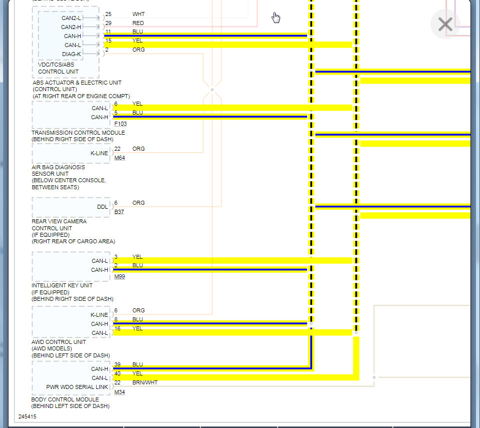

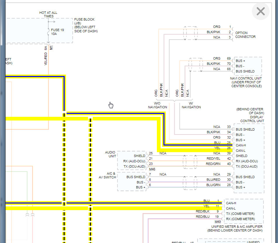

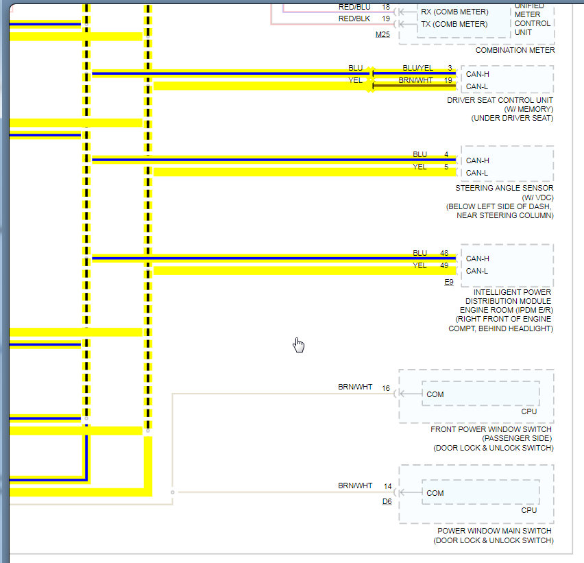

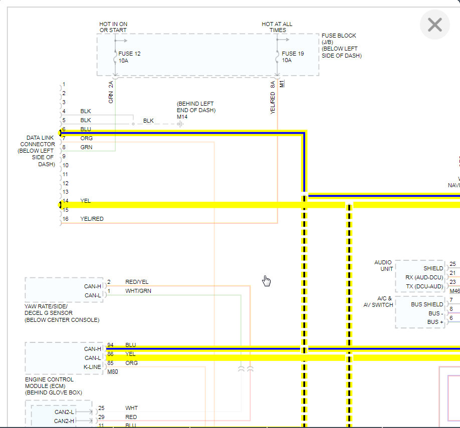

We can use a meter to figure this out. Let's start with what these codes are telling us. Basically the CAN network is the information highway in which each of these modules talk to each other. These codes are telling us that the ECM is not able to communicate properly on this highway. I am attaching the wiring diagram that you can see the two wires, blue and yellow go from the DLC to each of the modules. This is the the highway that we are talking about.
So let's start at the data link connector. This is the connector that you plug the scan tool into to read the codes.
Can you check power on pin 6? Then pin 14? So one meter lead in 6 and the other in 4 or 5 which is your ground. Then 14 and the same ground. The key is should be in the on position. Let me know what the voltage is on both lines.
Once we confirm we have good voltage we will do what is called a termination resistance check but let's start with the voltage because if that is not correct we will go in a different direction. Plus it can get too confusing if we include too much info upfront.
Let me know if you have questions. Thanks
Jan 23, 2021 at 5:36 PM

Thanks. We do have a voltage readings on Can H 2.7 volts and Can L 2.3 volts.
Jan 23, 2021 at 5:57 PM

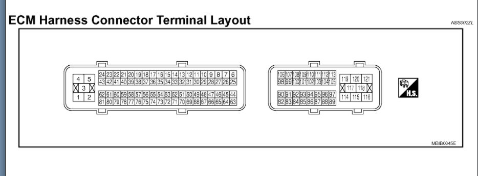

Perfect. Those are perfect. So now we need to go to the ECM and check power, ground, and bus voltage at that module since it appears to be the one that is not communicating.
So we need to make sure the ECM is operating as it needs power and ground. This is a safe assumption since the engine is cranking so it is getting the ignition switch feed and sending the signal to the starter to turn the engine over.
However, I suspect we have a connector issue at the ECM which is why we have the codes and the engine is not starting. Basically the ECM cannot communicate on the BUS to send the rest of the messages it needs to.
Also, I just want to check and make sure these codes were active and the theft light is out?
