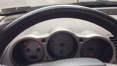

Car all the sudden in the morning would not start. Thought it might have been the battery jump started it and it sounds the same. Turns over but will not completely start. Starter sounds fine. Someone said it sound like a bad fuel pump or possibly dirty injectors. I included a video.

Non starting can be due to various causes and what you need to do first is to check/test what is missing. The link below gives a clear explanation of how to go about diagnosing the problem.
Go through and let us know how it goes. I will not rule out the possibility of a bad fuel pump, but bad injectors is less likely to be the cause as fuel injectors do not fail all at once and you should be able to start engine except it could be running badly.

Ignition immobilizer chip fell out of my key.
