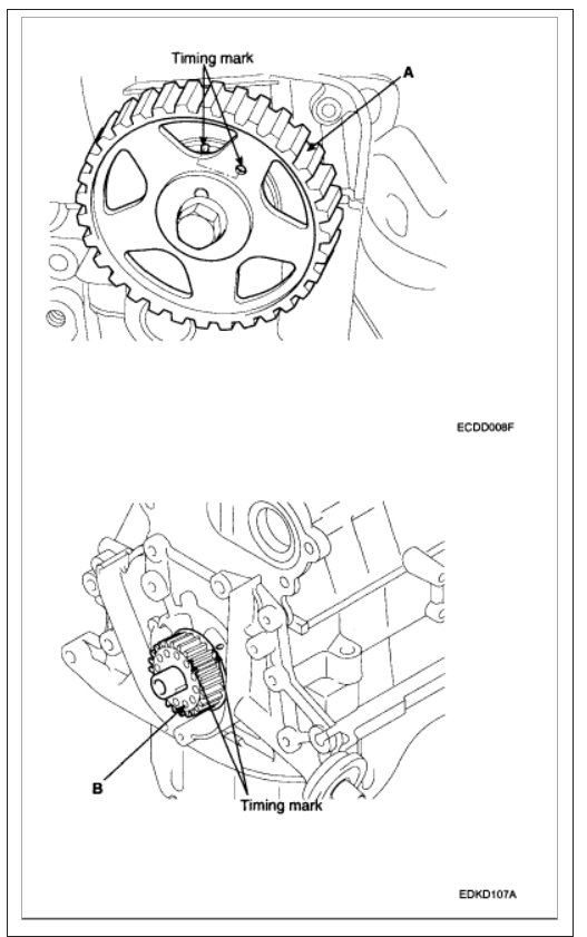

Car cranks after re-lining the engine block. Replaced rings, gasket and heater plugs, but will not start.
Thursday, April 12th, 2018 AT 6:06 AM
KEN L
MASTER CERTIFIED MECHANIC
55,130 POSTS
Lets start by checking the timing of the camshaft and crankshaft. This can be done by doing a simple compression test or checking the timing marks
