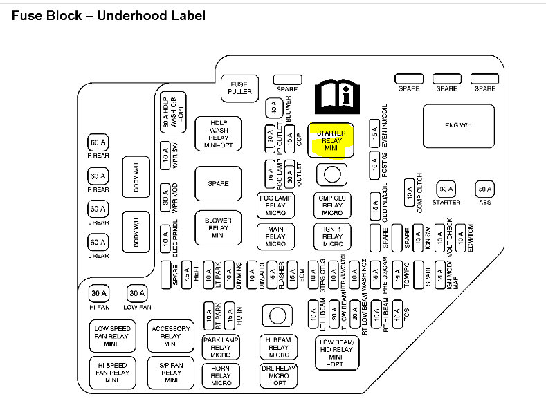

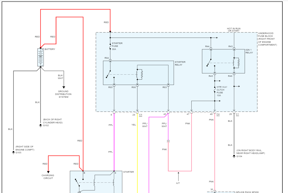

I want you to remove the starter relay. There are 4 pins on the relay. Two of the connector pins in the box should have power. Check that for me. Also, I assume you checked the starter fuse already.
See pic below.

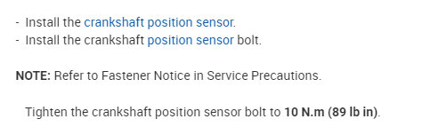

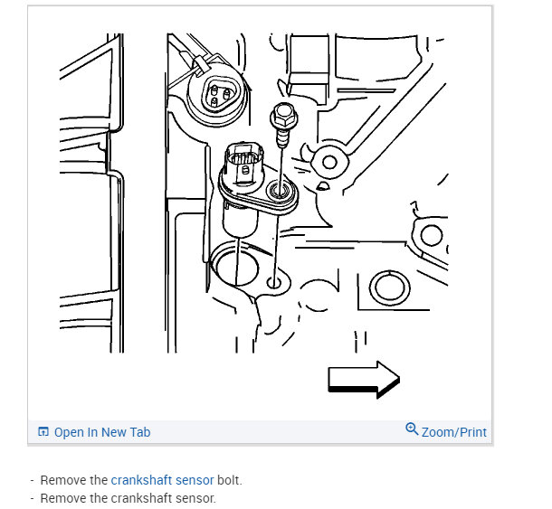

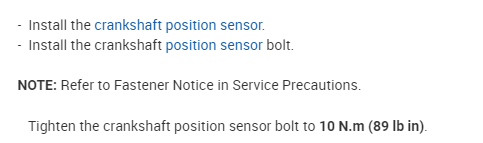

  • 110,192 POSTS

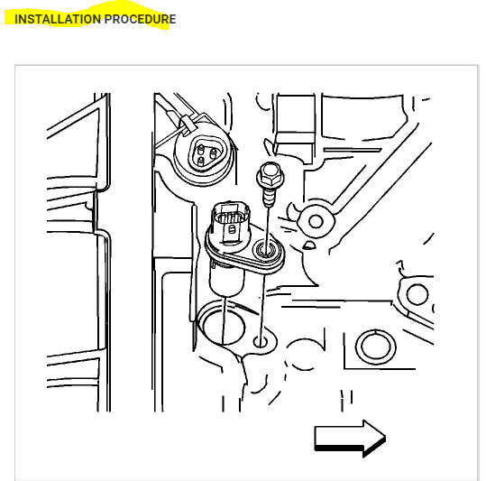

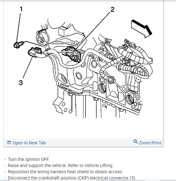

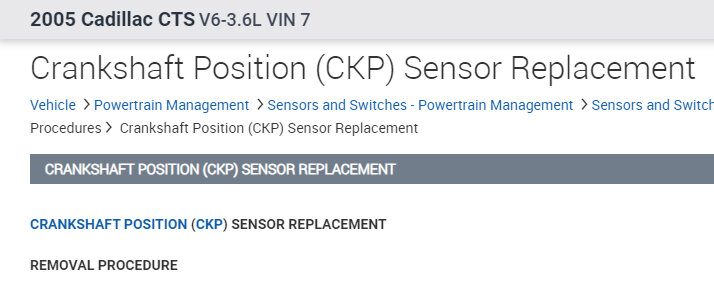

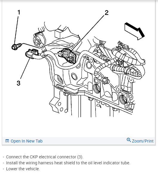

I don't know if they will help, but I attached the directions from my manual for replacing the crankshaft position sensor below.
