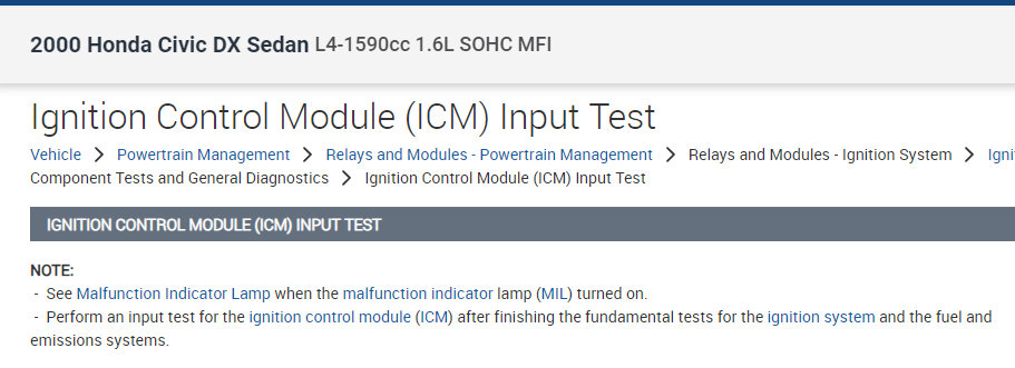

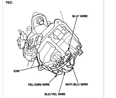

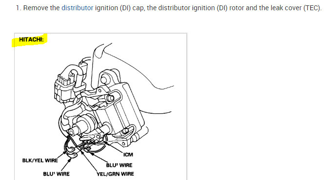

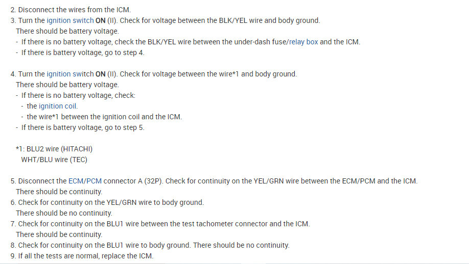

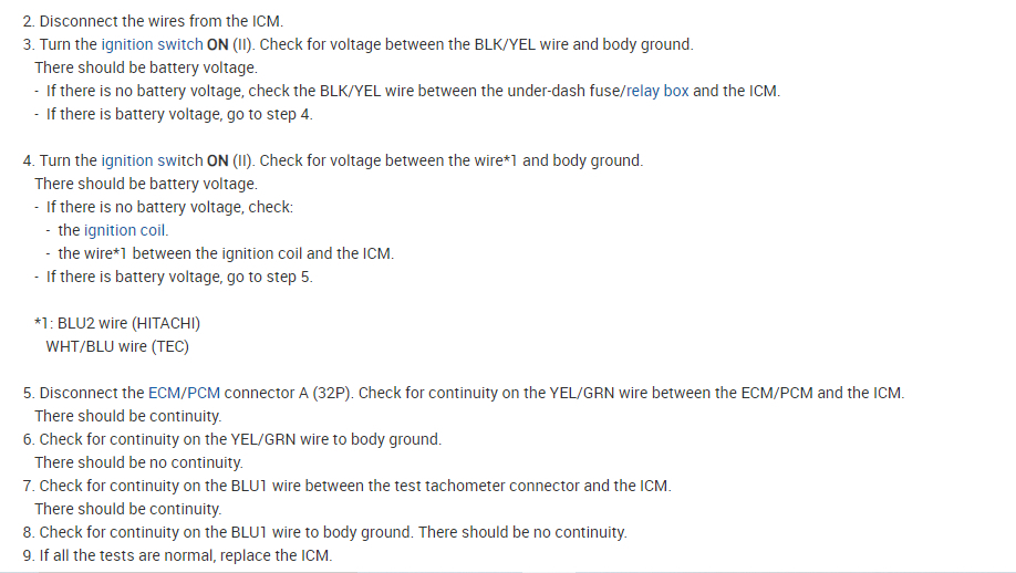

I attached diagnostics related to the ignition control module (ICM). Take a look through them and let me know if you are comfortable performing them.
Friday, March 15th, 2024 AT 7:02 PM
BIGBLACKBOI9
  • 33 POSTS

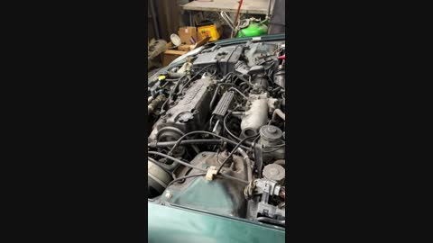

I haven't checked the ICM just yet due to little to no time but I will later today. But this morning I had a friend over and when I went to start the car it started but as soon as the video ended it started to idle by itself, I didn't need to give it gas. At 1.5 pm but the thing is I didn't touch anything from the last time I worked on it. What changed?

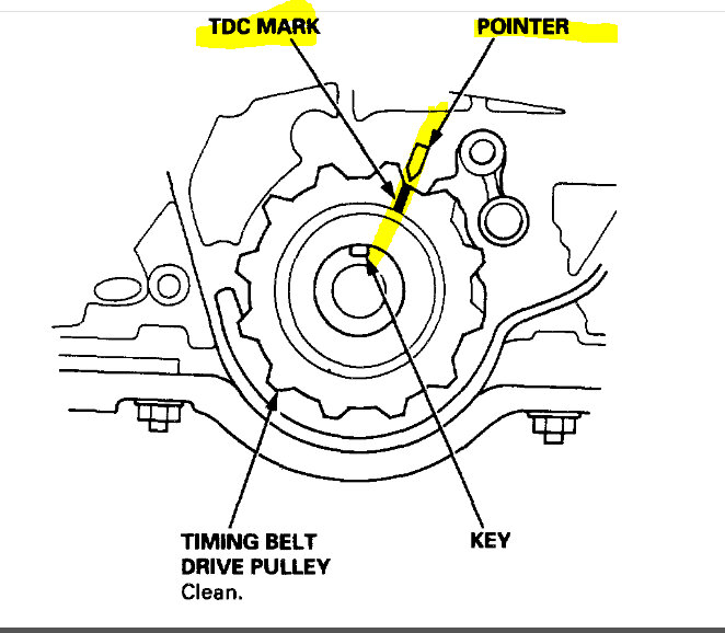

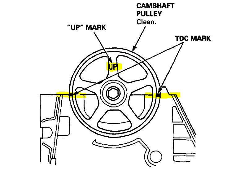

I noticed the timing belt cover is off. Have you checked to make sure the timing is correct?
Tuesday, March 19th, 2024 AT 7:12 PM
BIGBLACKBOI9
  • 33 POSTS
I tried searching up how but I can't seem to find the notches that are being shown in the video or any markings on the belt.
Tuesday, March 19th, 2024 AT 9:05 PM
  • 110,194 POSTS
I attached two pics below. One shows the marks for the crankshaft and the other shows the camshaft.

I checked the timing it looks all lined up. I haven't checked the Catalytic converter but before the car stopped running I did have a faulty catalytic converter code.
