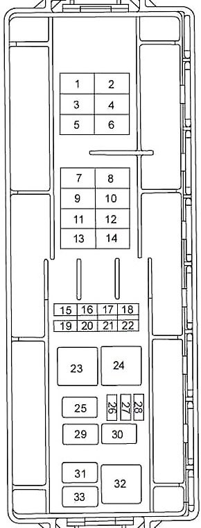

I have replaced the brake light switch, but still no brake lights and it won't shift out of park. I check the brake light switch with a multimeter and found that there is no power going into the switch. The wiring looks good going from the brake light switch to wire connectors and the brake light bulbs look good. The fuses look good, can you tell me the number of the fuse that is associated with the brake light switch? Not sure where to go from here.

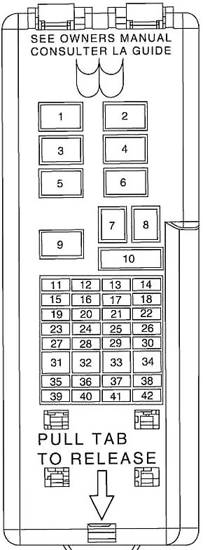

The pictures you send above don't look anything like fuse box on my car listed above. I have attached 3 pictures below (2 are the same).I'm not sure which off the fuses are for the brake switch.
The problem is when I check the brake light switch I don't see any voltage, I unplug the brake light switch and then connect my multimeter to the positive and negative sides of the switch connector and no voltage, I would expect to see 12 volts or more all the time on the positive side, is this correct or am I doing something wrong. Is it okay the way I'm using my multimeter for checking voltage.

I attached a picture and the location of the fuse block.

Roy, the fuse box you show above does not match the fuse box I'm seeing on my car. There are pictures above of what my fuse boxes looks like, I just need to know what fuse controls the brake light switch.
And if you can answer the following question:

See the attached diagram of the passenger and engine compartment fuses. These diagrams look nothing like the diagram you sent me??
I still don't know what fuse to look at that controls the Brake light switch, I checked most of the fuse in the attached diagram that sounded like they had anything to do with the Brake light switch and they were all okay.
So my problem is still; not getting any power to the brake light switch, and I think this is causing my brake lights not to come on and not being able to shift out of park.

I am doing my best to help you but you have not located the fuse box for the switch.
The fuse panel is located below and to the left of the steering wheel by the brake pedal. Remove the panel cover to access the fuses.
The picture I attached is the correct application for your car. Without being there, this is the best we can do. If you have your owners manual, chck for the location and a picture in the manual.
