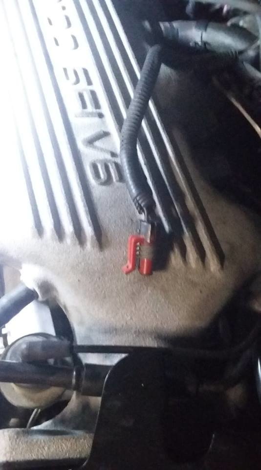

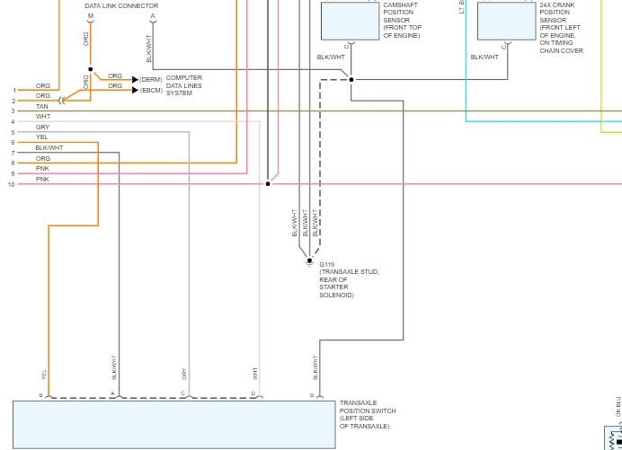

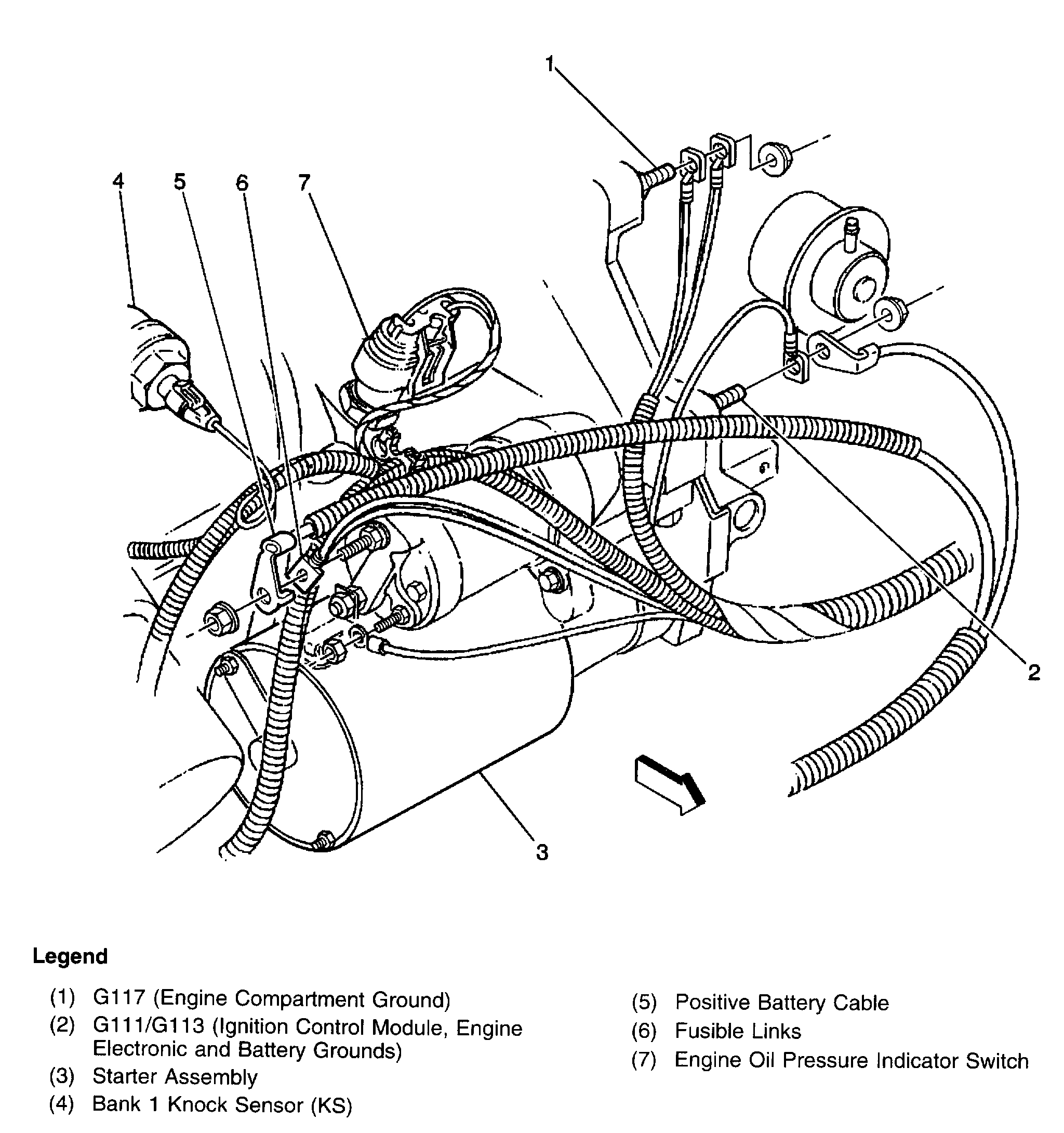

Blew a head gasket, changed out both, and new intake set, got everything back together, set valve rocker at 10 foot pounds ( suppose to be 124 inch pound, which = 10.333 foot pounds as I do not have an inch pound torque wrench) engine getting fuel and fire, but wont run. Compression test shows all cylinders averaging 126, with no leak down. Everything hooked back up to where it was except one plug we can find where it goes. (See image attached) Turns over great, small back fire through intake, just wont run. Any suggestions? Or any idea what the stray wire hooks to?

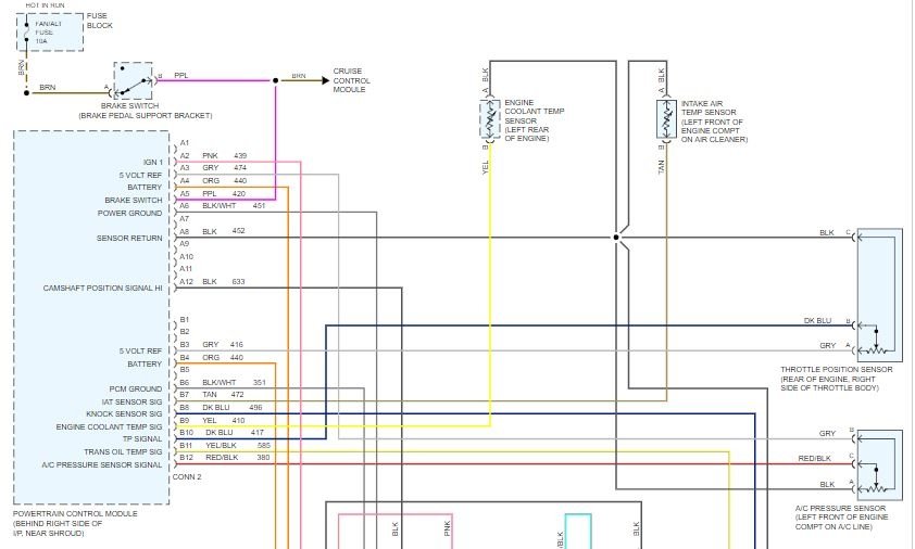

Is that a 2 pin connector? Are the wires black and pink? If so, check if it goes to the cam sensor. If that is disconnected, fuel injection timing will be off.
Also, see if it will start for a couple seconds using starting fluid. If it does, then the problem is fuel related. If it doesn't, reconfirm that there is spark. If the engine is getting both spark and fuel, the timing is correct, and it's can get air, it has no option but to run.

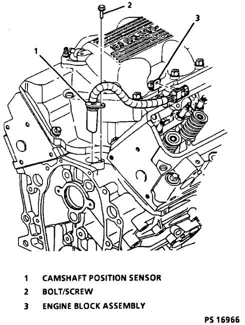

I attached part of a wiring schematic along with a picture of the sensor's location and where the plug is located.
Let me know if this helps and what you find.

Wire shone in attachment photo I sent is 2 prong, wires are black and white. I doubled checked the cam sensor wires and they are hooked up. Car will kind of attempt to run on starter fluid, but wont quite get there, also tries to backfire through intake after stop turning key.

I just read through the schematics again. I find nothing with a solid black and a solid white wire. The crank sensor is black and light blue.
Are you sure there isn't large vacuum leak causing it not to start?

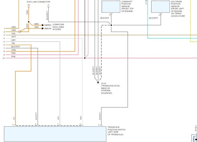

After looking closer at that plug, the wires are brown and white.
Everything vacuum wise is sealed or has its hose on it, so no vacuum leaks that I know of at moment. Plugs getting fire, not sure if injectors are spraying yet. But if you spray ether into intake, it still wont run on it, which has me perplexed.

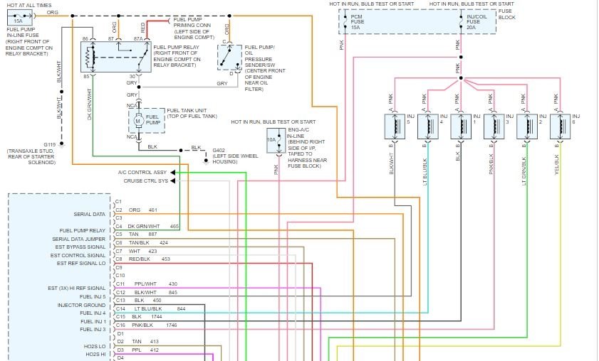

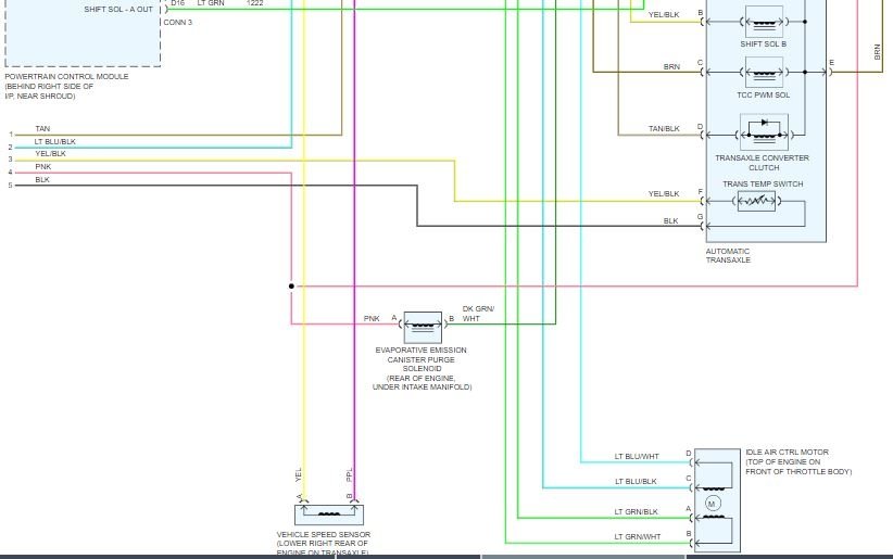

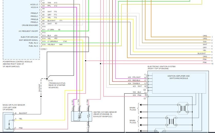

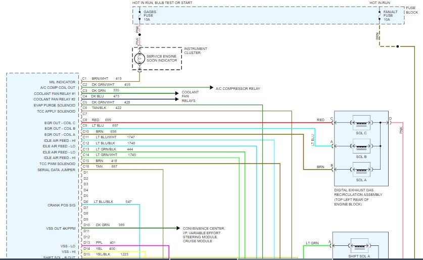

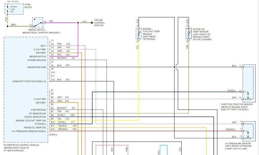

Okay, could it be tan? The Intake Air Temperature Sensor has a tan wire and a black. I am going to attach the schematics for the entire engine control power-train management system. I have to cut them in half for them to fit. I will kept them in order and overlapped them so you can see and understand them,
Honestly, it should start with starting fluid. Are you getting a good hot blue snapping spark at the plugs?
Let me know if any of this helps.
Friday, January 11th, 2019 AT 6:08 PM

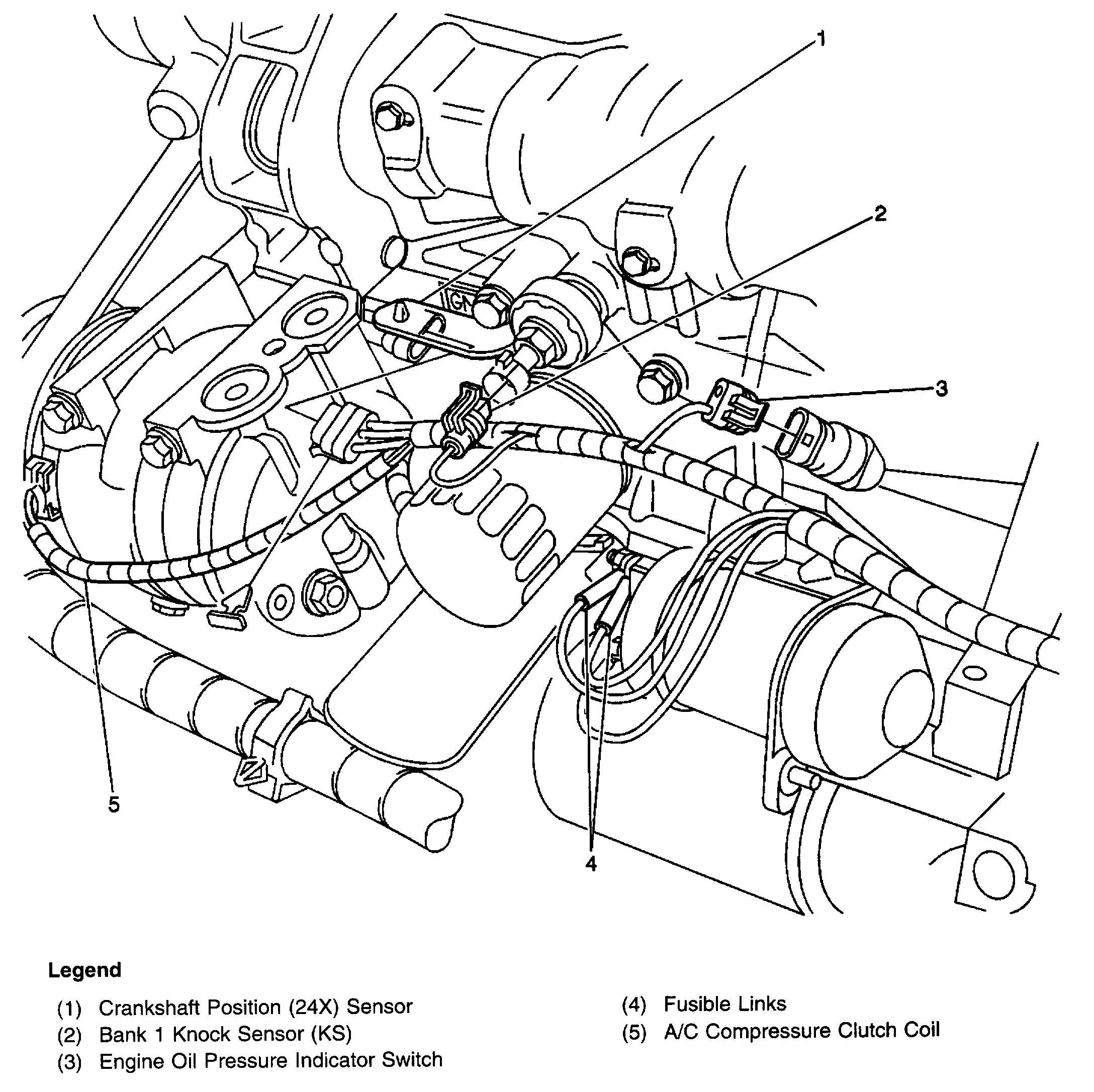

It should run. We are missing something simple. I am going to ask one of the other mechanics on this site for his opinion. However, if there is spark, fuel, compression, and the timing is correct, it should run. Take a look at the two pictures to see if that helps find the location of the wire that's disconnected.
Lets see if he has any suggestions.

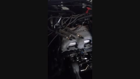

In the video the starter sounds a little strange is the engine turning over fast enough? I am wondering if you have spark at the right time? Does it even try to run can you do a video with the plugs in?

We got it running. :) JacobandNickolas last set of images had me double check all the wiring. Knock sensor was not hooked on tight, soon as we plugged it in good, car fired right up. Never seen a knock sensor keep one from running, but it runs, so not going to question it. Thanks much for the help!
Sunday, January 13th, 2019 AT 1:34 PM
  • 110,194 POSTS
Great! The knock sensor plays with ignition timing, so anything is possible. Regardless, I'm glad it helped and wish you a great 2019.
