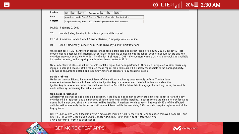

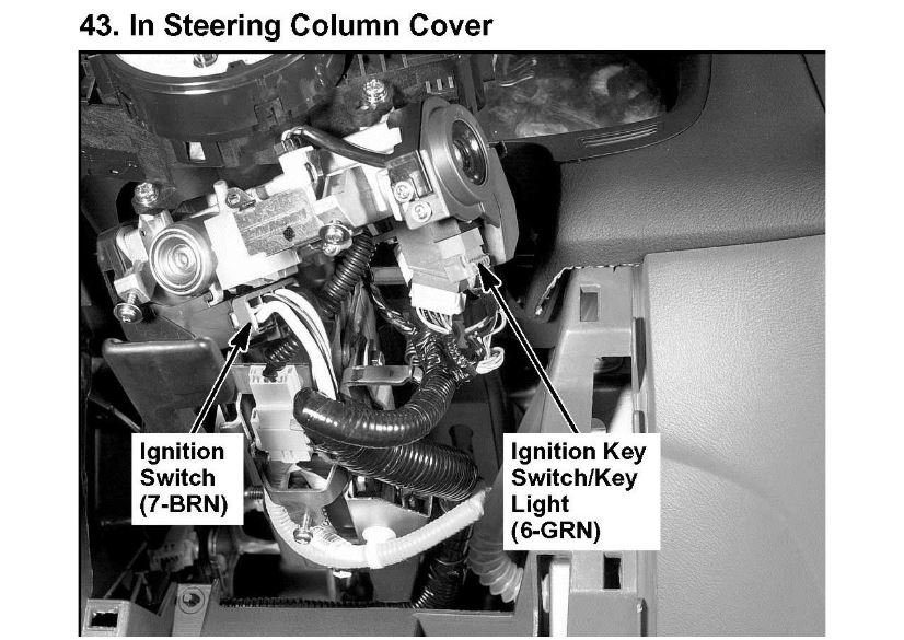

Hello, I recent purchased a used vehicle. I noticed at times my car would not crank. It will switch to the on position, but once turned to A/C car does nothing. Battery is okay, and just had starter replaced as I thought it was the issue. Twice now the car has not started. First time I went ahead with old trick of putting car in neutral then cranking. Second time I kept key turned to crank it (for what I felt was longer than a second or two), jiggled key a little further and car started up. I noticed two occurrences before changing starter that I resolved the issue "magically." Once was out of frustration and I banged all over the steering wheel and dashboard, near ignition switch. Ta-da car started. Second was the same as the most recent time except, again, it was more forceful; I jiggled the key around while cranking key and *vroom* again it started in enough time for me to get to work. I noticed a recall for vehicle:
NHTSA RECALL NUMBER: 10V-364
MFR CAMPAIGN ID: R44
CAMPAIGN DESCRIPTION: IGNITION SWITCH RECALL
RECALL DATE: 08/04/2010
Is entire ignition switch faulty? Can it just be the pins? Is it possibly a loose wire elsewhere in the process a car goes through to start? If I take it to a dealership to inspect the recalled parts and it fails the tests mentioned in photo attached will it resolve the issue? Further information is greatly appreciated. Thank you.

Good morning.
You can call the dealer service and give them the VIN number and ask them if there are any open recalls. Recalls never expire.
Yes, it can be the switch and it was a common failure for this. Yes, the entire switch has to be replaced.
