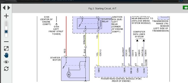

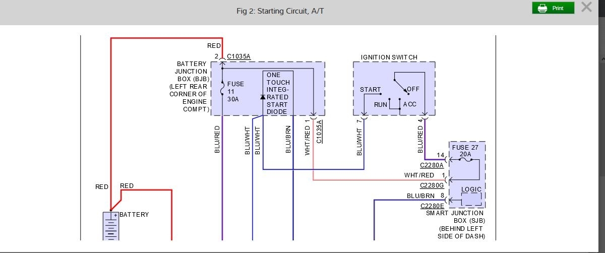

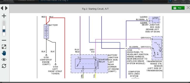

Since Thursday I have tried to start it more than fifty times, with no faults. This afternoon I drove it for over half an hour then tried to start it while it was warm and got a failure after a couple of tries. Then tried it several times without a failure. Went back out after about fifteen minutes and it failed again after a couple of tries then I tried several more times without a failure. I am going to take it out later for a drive and see what happens. Do you happen to have access to an electrical schematic for the starter circuit and also how the PATS would be connected?
Thank you!
Sunday, November 5th, 2017 AT 6:15 PM
MHPAUTOS
  • 31,937 POSTS
The PATS has a control module and also requires input from other sources as well. I will chase down the schematic and get that off soon.

I have broken up the information into three pieces, to try and get some better detail.
+1
Sunday, November 5th, 2017 AT 11:21 PM
BERNIE WORBY
  • 11 POSTS
I got the pictures. Should help a lot.

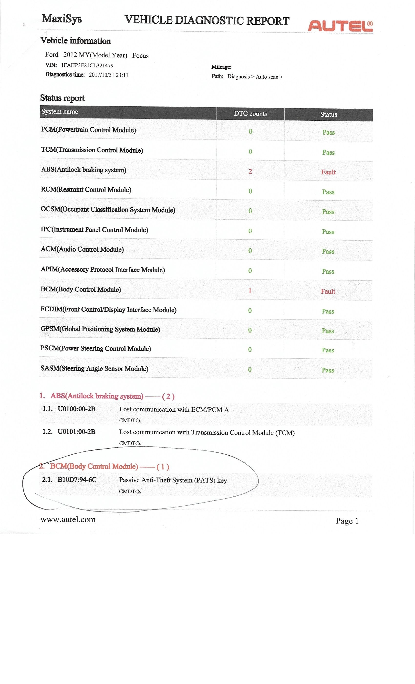

They have pin point tests for a range of PATS fault codes, have you had a scan to see if any code are set? If so we may be on the way to fix this problem.
Wednesday, November 8th, 2017 AT 12:52 AM
BERNIE WORBY
  • 11 POSTS
Here is a JPG File. He got both keys from me and ran into a dead end.
Wednesday, November 8th, 2017 AT 8:58 AM
MHPAUTOS
  • 31,937 POSTS
It looks to me as being a problem in the BCM module, from what I can find, the PATS is integrated into the BCM ford can do what is called an on demand test on the BCM, this is a deep scan, more so than a general code retrieval and identification, let me know if you can get this done at a local dealer.

Thank you for all of your responses. The dealer replaced the transmission control module. The best thing is there was no cost. Because of all of the transmission problems, the warranties had been extended to 100 and 150 k miles. Thanks again and have a great evening.
Bernie
Tuesday, November 21st, 2017 AT 5:32 PM
MHPAUTOS
  • 31,937 POSTS
That surprises me that they replaced the TCM, there is a connection with the TCM and the BCM and PCM I would not think that the problem would have gone back to a faulty PCM but stranger things have happened, end result is that they have found a problem and you are all sorted, thank you for using 2carpros.
